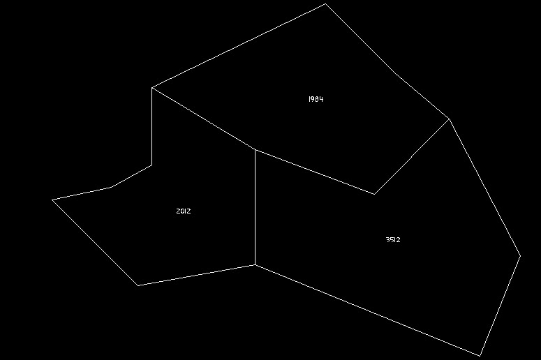

Say I have 100 irregular hatches. I want to somehow display the area of each of these hatches on the screen (i.e. area labelled over top of the hatch). I know I can check the properties of each hatch individually to find the area but was wondering if anyone knows of a better way?

Finding the area is one thing (easily solvable with a custom lisp routine). Actually displaying the area atop the hatch is another.
Can you give us an idea of what you want that to look like?
I've found a few area/polyline labeling lisps and been trying them although the ones I have found all require you to pick the insertion point for each piece of text label, which doesn't really help much.
I don't really care how the text/label looks so long as it is over the hatch and you can recognise it as being for that area.
So you don't want to indicate where to place the text. You want the lisp routine to just "do it". That about sum it up?
Basically, yes. The area labels are not for presentation but for working purposes.

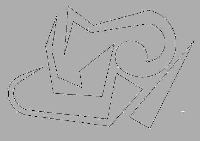

One of the problems with autoplacing is it can on a shape say like a U put text outside of the area, Remark with your code maybe need a is this ok else move it.

Btw i've made some additions/changes to that. Tried to submit it as an attatchment but that didn't worked out. Sorry for posting is as code instead of attatchment!
Maybe this text part needs a bit of work started with lee's http://www.cadtutor.net/forum/showthread.php?31653-Lisp-coordinates-of-points-to-excel-sheet-(-point-number)/page3 so I would add back in the error checking etc.

I've replied to this thread last night ... im not sure if there was something wrong with my post. maybe a moderator can answer me?? Thank you
Try this quickly written program, based on my Area Label program:

Adapted my code here + Lee's routine.
;;   Write the area of the selected polylines in the position of   ;;
;;   maximum inscribed circle.                                     ;;
;;   19.01.2013 - Gian Paolo Cattaneo                              ;;
(defun c:arpoly (/ sel poly POLY_vl Dx Dy Lp List_vert_poly list_p_int P_center dist step1 step2)

(defun Point_int (/ P_distant n Pr cont attr p# Pa Pa_ Pb )
   (setq P_distant (list (car (getvar "extmax")) (* 2 (cadr (getvar "extmax")))))
   (setq list_p_int nil)
   (foreach Pr Lp
       (setq cont -1)
       (setq attr 0)
       (setq p# nil)
       (setq Pa (nth (setq cont (1+ cont)) list_vert_poly))
       (setq Pa_ Pa)
       (repeat (length list_vert_poly)
           (setq Pb (nth (setq cont (1+ cont)) list_vert_poly))
           (if (= cont (length list_vert_poly)) (setq Pb Pa_))
           (setq P# (inters Pa Pb Pr P_distant))
           (if (/= P# nil) (setq attr (1+ attr)))
           (setq Pa Pb)
       (if (> (rem attr 2) 0) (setq list_p_int (cons Pr list_p_int)))
   (setq b list_p_int)
; Infittisce la griglia inserendo altri punti
; nel centro delle diagonali tra i punti interni
; Increases the grid density
(defun grid+ (/ G+)
   (setq G+
       (mapcar '(lambda ( x ) (list (+ (car x) (/ Dx 2)) (+ (cadr x) (/ Dy 2)))) list_p_int)
   (setq list_p_int (append G+ list_p_int))
   (setq c list_p_int)
; Da una lista di punti restituisce quello più lontano da un oggetto
; dati:  - lista dei punti -> list_p_int
;        - oggetto -> POLY_vl
; Returns the farthest point from the polyline
(defun Point_center (/ Pa n Pvic)
   (setq Dist 0.0000001)
   (setq P_center nil)
   (foreach Pa list_p_int
(setq Pvic (vlax-curve-getClosestPointTo POLY_vl Pa))
       (if (> (distance Pa Pvic) Dist)
               (setq P_center Pa)
               (setq Dist (distance Pa Pvic))
   (setq jjj (1+ jjj))
   (setq pc P_center)
(vl-load-com)
(prompt "\n ") (prompt "\n ") (prompt "\n ")
(princ "\nType \"ARPOLY\" to invoke")
