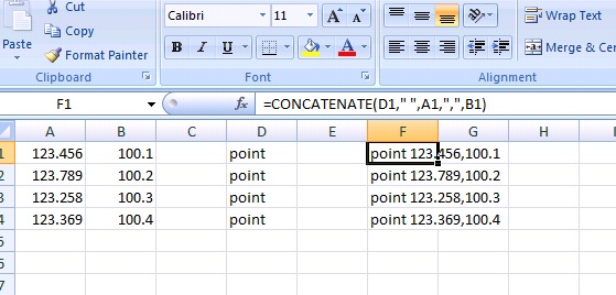

BIGAL Posted January 29, 2013 Posted January 29, 2013 1st Simplest way is to create a block with the marker and 3 attributes. Label, X & Y set up the way you want them to look In excel you can make the commands to create this all in one step Using contenate you join the relevant columns to make 1 single column Insert yourblockname x,y rotation scalex scaley scalez attrib1 attrib2 attrib3 Insert yourblockname x,y rotation scalex scaley scalez attrib1 attrib2 attrib3 Insert yourblockname x,y rotation scalex scaley scalez attrib1 attrib2 attrib3 This example inserts points just copy column F and paste onto command line. Do one manully and write down every question that autocad asks this what you need to duplicate. 2nd part export is even easier if you have made the blocks just use DATAEXPORT it will do it all for you. Quote
lewissheen24 Posted January 29, 2013 Author Posted January 29, 2013 I can make the block with the attributes, the rest i can't understand . Your going to have to provide instruction step by step, not missing out any steps. Treat me like a idiot! Quote
