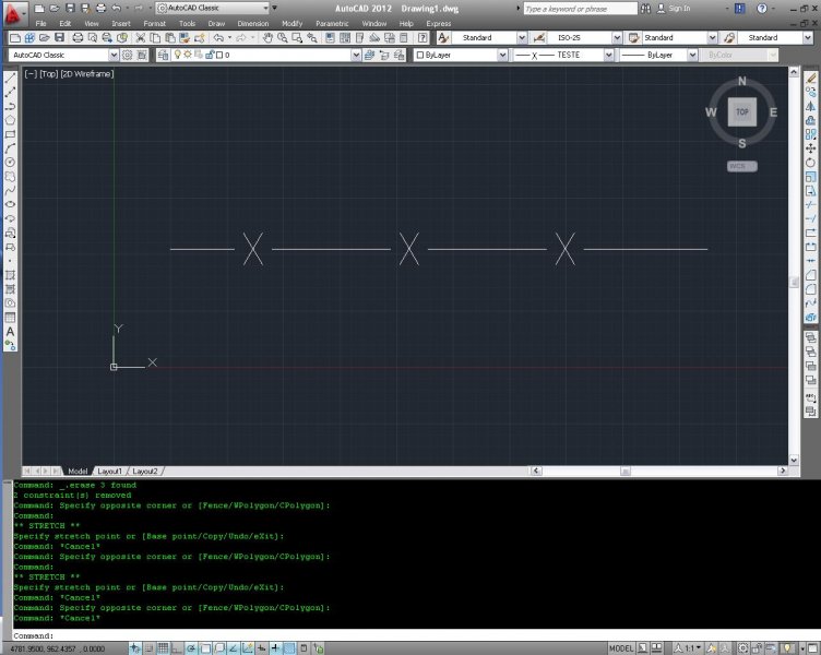

NEXTMARCUS Posted January 23, 2013 Author Posted January 23, 2013 (edited) Ho of course , i find a way to create it using mkltype with an existing shape i just draw the symbol i want and used the comand mkshape, after save the shape draw it again and used mkltype to create the new linetype. SHAPE: *1,58,TEST 4,250,4,4,3,113,3,89,3,18,002,9,(64,64),(0,0),001,9,(-127,-127),(-1,-1),(0,0),002,9,(0,127),(0,1),(0,0),001,9,(127,-127) (1,-1),(0,0),002,9,(-64,64),(0,0),001,4,18,4,89,4,113,3,4,3,250,0 LINETYPE: *TESTEX,-X-X-X-X-X- A,1,-.453019,[TEST,C:\Documents and Settings\marcus-ramalho\Desktop\testshape,s=1],-.453019,1 Result: Edited January 29, 2013 by NEXTMARCUS Quote
