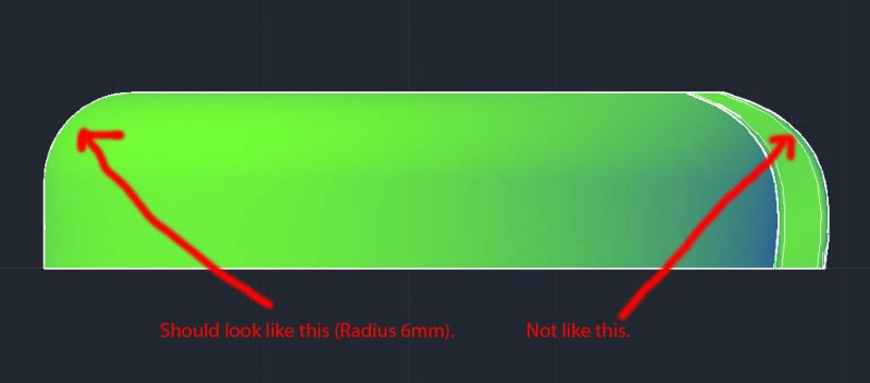

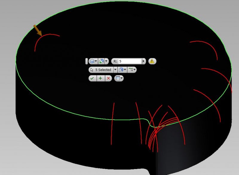

I want to put a 5 mm radius fillet on the upper edge. After 1.5 mm it will not...Why? What can I do? Convert it to a mesh object? Or? Would be greatful for some help.
3Dfilletedge_problem.dwg
Fillet.jpg5mm looks to be much to large to me?

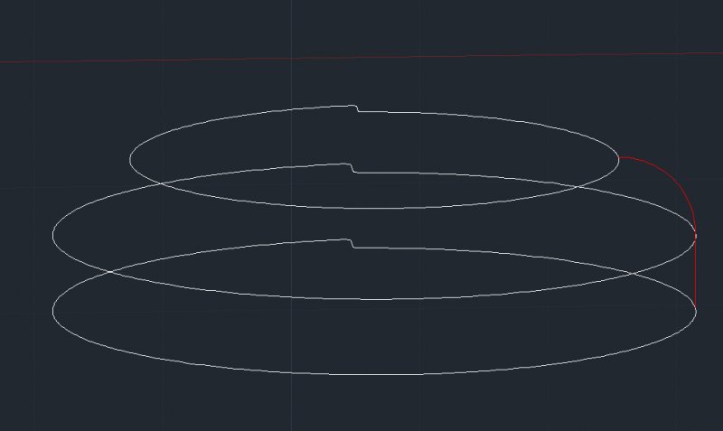

I think you are going to have to use Loft.
Okey. Shall I loft it with a path, guides or duplicate/downscale several 2D-polyline.

Please, help me get this top right. I want to loft it with a specific radius (6 mm) round the top. I´ve tried Settings-draft angles... but no. Path? Guides?
-frustrated/hopefulloft_problem.dwg

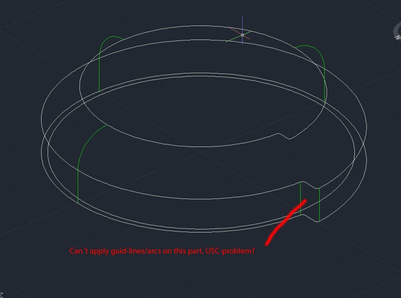

Desperately need help to loft this top. Have managed to loft it 3/4. Big problem with. HELP...
loft_guides.dwg

Are you familiar with surface modeling?
Good thought JD, as I don't believe it can be lofted as desired, after giving it a go.
Ok. Thanks. Then I have to get familiar. Suggestions on relevant tutorials?
There are a bunch of AutoCAD surfacing tutorials in my signature. (for v2007, so the interface has changed a bit)
