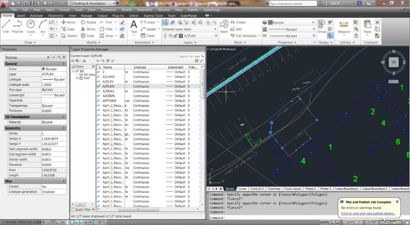

i have a drawing that ive set all the lineweights and types to by layer and continous and then made sure layer is default
the problem is now ONE line in the drawing appears thicker and when i print it out it appears very faint
can post pict if anyone needs

line in problem.. other grey lines on same layer and plot correctly

color is 8
and im trying to print in monochrome
found the problem.. the global width overrides everything apparently :S
