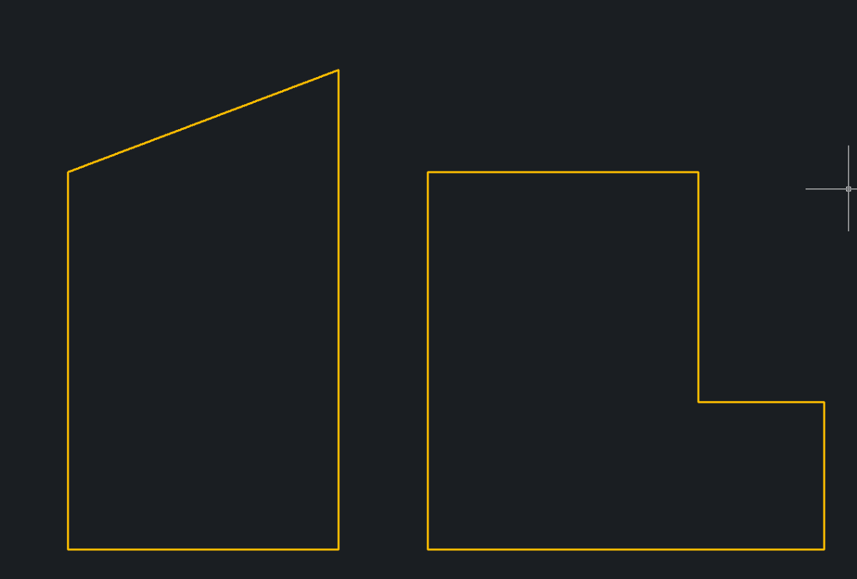

Hello @Lee Mac
I just found your LISP for floor heating and it is wonderful, thank you for it!
I was wondering if is there a way to make it work with other rectangular-like shapes (like attacheted ones).
Cheers!

"rectangular-like shapes" now  "Polygon shapes"
If you dont want a spiral solution but draw hor or ver parallel piping should be feasible, you need to post a dwg what is your solution to the problem as per image, before any one jumps in and goes entirely in the wrong direction with code.

Hi, thanks for answering!
Unfortunately I need it to be a spiral shape. As you requested I am attaching examples of a room shapes and my idea how solution could look like - as you can see in second example it doesn't even need to be perfect for my use (middle section is not idealy matched).
Cheers!
Drawing1.dwgFetching info...
