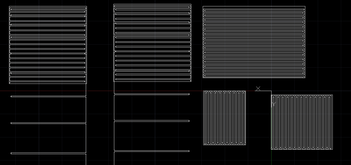

A challenge: how to draw this? Floor heating ...
  • 2 months later...
Hi all is it possible to get a lisp routine to draw the circuits parallel see attachedufhl.jpg

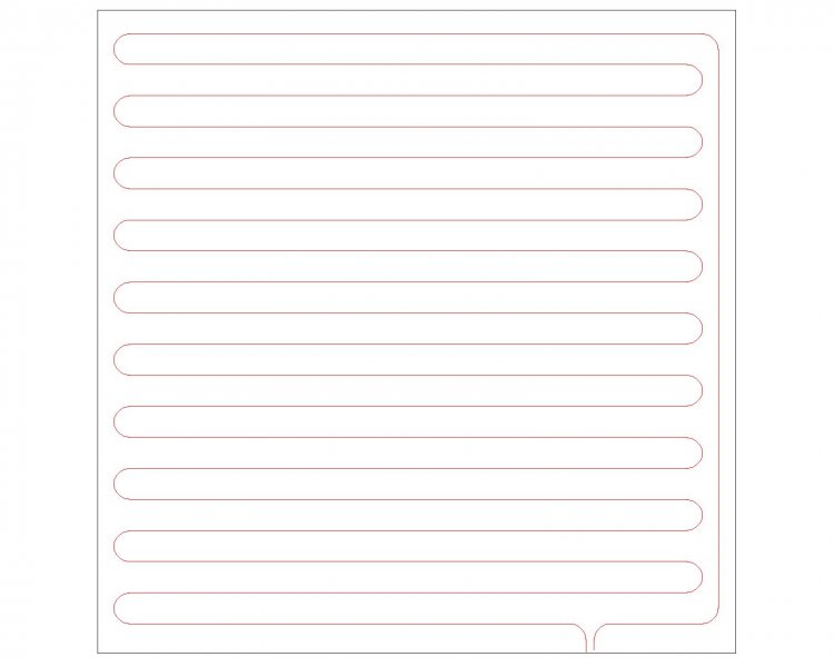

  On 11/12/2013 at 9:10 PM, marko_ribar said:
Is it possible to create this?  Because one pipe style is not very preferred in heat transfer aspect. Inputs can be distance between lines and radius.
LeeMac, in your heat grid LSP, how could i eliminate the radiuses? I would like that the joints to not be rounded at all, so it is easier to move them around.
  On 3/1/2020 at 10:36 PM, arber96 said:
I see your example...
Try this code :

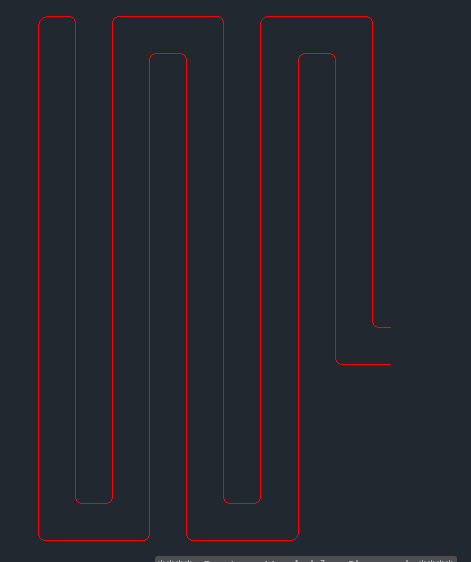

  On 3/5/2020 at 4:52 PM, marko_ribar said:
Thank you so much, you have done an amazing  job. But i think there is a problem, sometime it gets out of rectangle.

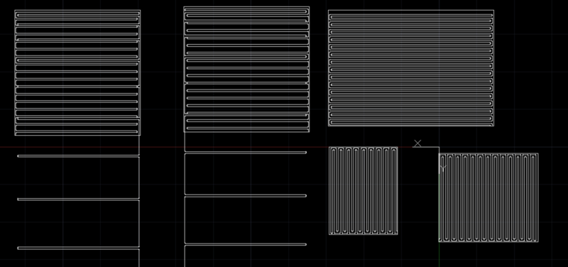

Hi @arber96,
can we see sample DWG for testing...
Can you upload DWG instead of pictures?
Also it would be nice if you provide us exact inputs you did when wrong results occur...
Edited by marko_ribar
  On 4/25/2020 at 3:15 PM, marko_ribar said:
Hi @arber96,
I attached dwg file and commands. I tested it in autocad 2020 MEP but the same result i got in autocad 2016 and 2021.
testingfh.dwgFetching info... command.txtFetching info...
I think I fixed it...
Try this mod... BTW. Thanks for reporting...
