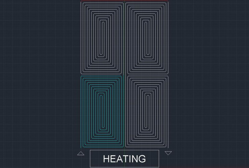

Hi to all CADTutors,

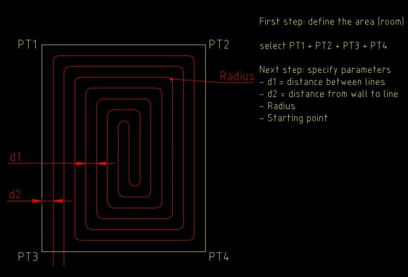

Every now and then I receive a drawing from a third party wich contains a floor heating plan. To be clear: I do not have to draw this myself, it is done by others.
But I can't keep myself from wondering how this is drawn. My guess is that there is some kind of reactor involved. Like in the Vlisp developers bible; in that case a garden path is drawn as example. The reactor makes sure the objects stay between the polyline.
So is this one, define a room (4 walls) and then define the floor heating. The program calculates various things and then projects the polyline as shown in the image.
The challenge / question is: how to automate this?
Maybe others in this forum know about floor heating or even have the answer...?

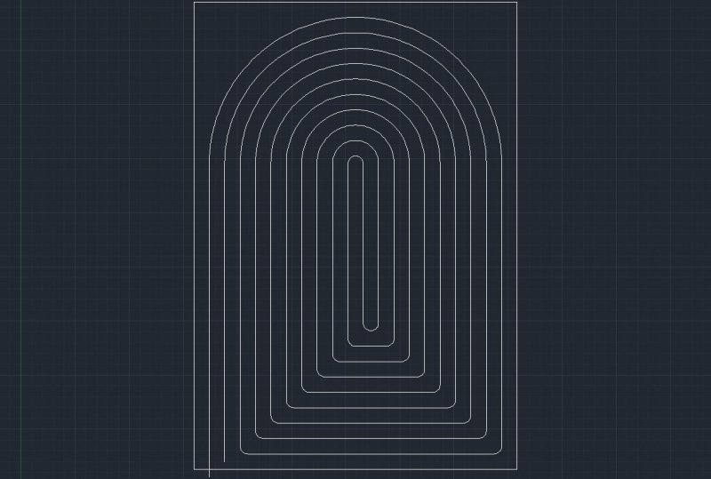

Here is mine version... d1=d2 ... You only have to specify level of detail...

M.R.

Hi Fixo, thanks for the reply, this is indeed what I mean. There are some issues
like the middle spiral as you say. But the idea of selecting the room and then specifying the parameters is the way I think it should be.

Also thanks Marko; this result is the best. However to specify the amount is not quite the way it works I believe. More important is to specify the distance D1.
Another thing: D2 is not necessarily D1. I mean if D1 is 150 then it may be that D2 ends up being 100 or 200,... depends on what remains.

This seemed like a fun challenge, so I thought I might participate...
Here is my version:
The attached program will prompt for a rectangular closed LWPolyline and a 'wire spacing' (the distance between the coils), and will generate a maximal filleted spiral centered within the selected LWPolyline.
The program should perform successfully with all rectangular closed LWPolylines, at any rotation or orientation, and in all UCS & Views.
For an arbitrary rectangle of any dimension, one cannot specify both the spacing between the coils and the offset from the rectangle boundary, since multiples of these values will not necessary equate to the rectangular dimensions.
Hence, my program will prompt for the spacing between the coils and will center the spiral within the selected rectangular LWPolyline, maximising the number of spiral coils for the given spacing, with the division remainder equal to the offset from the boundary.
If the spacing is a multiple of the dimensions of the boundary, the program will offset the spiral from the boundary by the given spacing to ensure that the coils do not touch the boundary edge.
The code isn't pretty, but should hopefully perform correctly.

Look into this example... This scheme was produced from my last routine... Firstly draw rectangle, then offset it for a distance the pipes will be away from the walls... Then divide that new rectangle into 4 smaller ones, and apply my code on one of them - lower left one... Then erase 4 rectangles and just mirror newly created polyline make sure that horizontal mirror around y axis be at half distance between pipes... Then make arc for upper right corner, and place it at the end pipe of upper right mirrored polyline... Do the same for upper left arc, and at the end draw line from one arc to the other... You should get what is shown in the picture... I suggest this for larger rooms where length of pipes is limited... As you can see, you'll get 2 ends from pipes at the bottom of the room - one with warm matter supply and the other with cold matter drainage...
M.R.

This is a combination of 1st code and 4th code... 1st and 4th are compatible and 2nd and 3rd also...
See picture, you can now quickly make this pattern if one side of room is round...
M.R.
