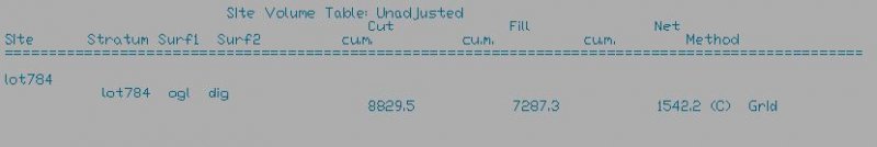

earthwork volume,cut and fill calculation.
Can anyone help to calculate the volume.I attached here
my dwg file.
I never done this before and I want to know the correct answer when
I want my land to be levelled at 6m.How much volume to fill and the land
to be removed.Thanks in advance.
lot784Nsang stadia field.dwgFetching info...

From the size of this survey, solving this should take maybe 10 minutes to complete. Label the contour lines, so it is easier to read. It looks like the interval is 1m.
And if you do want to remove the entire hill to 6m, contour lines 6, 7, 8 and 9 should be closed (the ends connect to each other). Otherwise the problem cannot be solved accurately.
The approximate volume can be calculated by hand by finding the area of each contour line from the elevation you want the level down to, and adding them together. I get a cubic meter quantity calc of 10,450 with the open contour lines.
However, you will pay for what is actually hauled away, and that is the more important quantity.
Having looked at the drawing, I would make the following comments.
The contours have been interpolated from the surveyed spot levels. The contours have then been curve fitted to give a "nice" picture. You would get a more accurate calculation of the volume if you used the original spot levels, especially as the contours do not always go outside the boundary, whereas the spot levels do.
There is no exact solution because of the way that different programmes calculate the volume, but using a programme that is written to calculate earthwork volumes is the easiest way to go.

This is what I get using the original spot levels and Land Desktop.
Be warned that there are 6m high vertical faces on one side, and 3.5m vertical faces on the other side. And no bulking has been taken into account.
I thank you very much eldon for giving me the complete answer.
So the total volume of the whole lot is 10,371.2m3 am i right.

10,450 m3 is the volume removed to elevation 6m.
The problem with your site is that the contours are not closed, and all I did was look at the area via properties for each contour elevation and add them together. It's the new old school way of doing cut/fill calculations. The old old school way of doing these calcs was with a planimeter on paper plans.
Just to remind you again, your survey was incomplete, and you will be leaving a vertical walls of soil adjacent to the property line. Also, I did not do any fill calculation.
