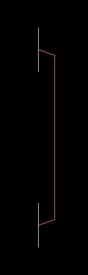

I'm trying to figure out what I would understand to be something simple. I want to create a lisp that I can tell it to draw 3 lines and then I can specify if it goes to the left or to the right. Here is the basic of what I have so far.
(defun c:ju()
 (setq oldosmode (getvar "osmode"))
 (setq oldlayer (getvar "clayer"))
 (setq	p1  (getpoint "\nPick Top Point:")
p2  (getpoint "\nPick Bottom Point:")
lvl (getint "\nJumper Level: (1,2,3,4...)")
 (setq	p3 (list (+ (car p1) (* lvl 0.09375))
	 (- (cadr p1) (* lvl 0.03125))
 (setq	p4 (list (+ (car p2) (* lvl 0.09375))
	 (+ (cadr p2) (* lvl 0.03125))
 (setvar "clayer" "text0")
 (command "line" p1 p3 "")
 (command "line" p2 p4 "")
 (command "line" p3 p4 "")
 (setvar "clayer" oldlayer)
 (setvar "osmode" oldosmode)
This is what it creates
[ATTACH]39491[/ATTACH]
Now, that works great and I need is to specify that I would want that jumper to go to the right or the left of the 2 white lines. I could use some help.

Easiest way is to not have to type an answer add pick left or right as a 3rd getpoint using mouse is faster, then do one routine just need a swap end points test for left or right.

Do you want faster than type "L" or "R" ?
then, pointing left or right of p1
(defun c:ju()
(setq q (getpoint p1 "\nDirection:"))
(if (>= (car q) (car p1))
(setq opt "+")
(setq opt "-")
(setq	p3 (list ((eval (read opt)) (car p1) (* lvl 0.09375))
(setq	p4 (list ((eval (read opt)) (car p2) (* lvl 0.09375))
