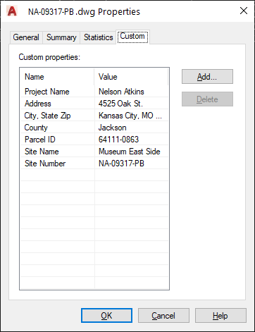

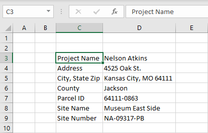

Terry Cadd Posted August 19, 2021 Posted August 19, 2021 I recently received an email from someone asking me to take a look at this thread and see if I had a possible solution for his company. I have never used DwgProps, but with the help of some very useful posts on the forums by Gilles Chanteau, I was able to create NewProps.lsp to extract information from an Excel file and put it in DwgProps. I would recommend testing it in a new drawing first. Download and copy NewProps.lsp to a folder in your AutoCAD Search Path. You can download the latest version of GetExcel.lsp from https://autolisp-exchange.com/AutoLISP-Code.htm . Download the images and spreadsheet here to look at and test. Load NewProps.lsp and GetExcel.lsp and type NewProps on the command line to run it. Best of luck. Terry NewProps.lsp NA-09317-PB.xlsx Quote
BIGAL Posted August 20, 2021 Posted August 20, 2021 (edited) Very nice maybe go other way and write a macro in excel so pick top cell c3 pick bottom cell c9. Excel controlling Autocad is not hard. There may be a get current cell function in excel but can access in Autocad similar to the getcell function, then no need for dcl. I do something similar where lisp waits for a OK click then does my version of getcell. Bit like current selection. Something like this in vba but need to rework into a VLISP version it returns like image so should be able to work out row cols. Sub test() Dim myString As String myString = Selection.Address MsgBox myString End Sub Something along these lines (vlax-get-property (vlax-get-property myxl "ActiveSheet") "Range" "Selection") any ideas any one ? Edited August 20, 2021 by BIGAL Quote
