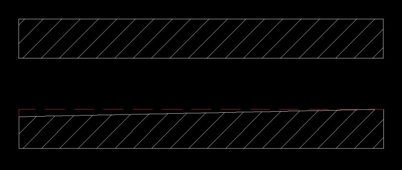

I'm trying to work on this plate # 3 and 4 but I'm having problems on what is should look like I see this one but it hard to read, I trying to do the out side wall of the building.
I needed to build a 14" wide steel plate welded to the top end of the steel column. weld is a 1/2 fillet-14" steel plate is 1 1/2" thick at its exterior edge and slopes toward the building interior at a rate of 1/4 every 1'-0"
I'm not sure what is should look like. please help.
The object at the top is a 14" wide x 1 1/2" thick plate shown in section. It is not beveled.
The object below is beveled at 1/4" per foot. The height on the left is 1 13/64" compared to 1 1/2" on the right. Notice the red dashed line. That represents the portion of the plate that would have to be ground down to achieve the slope required.
Does this help?
