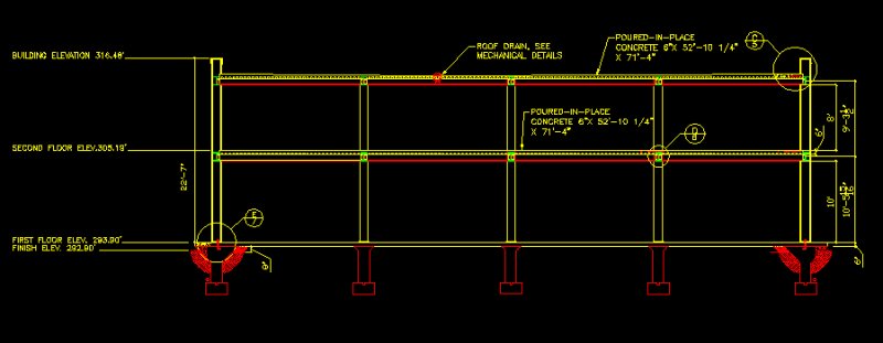

solo8591 Posted January 2, 2013 Share Posted January 2, 2013 (edited) is anybody has the drawing for structural drawing for plate #3 from pennfoster i just want to compare it, got a little confused that will be very greatful Edited January 2, 2013 by solo8591 Quote Link to comment Share on other sites More sharing options...

ReMark Posted January 2, 2013 Share Posted January 2, 2013 This is what one student drew for Plate #3 of the structural project. Quote Link to comment Share on other sites More sharing options...
solo8591 Posted January 2, 2013 Author Share Posted January 2, 2013 thanks for the post i will see how much i can see and get out of it , and what is the red portion under the first/5th colum that area was for the earth haching in my #2 plate Quote Link to comment Share on other sites More sharing options...
ReMark Posted January 2, 2013 Share Posted January 2, 2013 The red below the two columns is hatching for the sand base and the earth below. Two different patterns. Quote Link to comment Share on other sites More sharing options...
solo8591 Posted January 2, 2013 Author Share Posted January 2, 2013 so it is pretty much same thing with the #2 plate, i dont see no much diferent @all except a few thing beside the hatching size .i did the roof in the 2nd plate too . Quote Link to comment Share on other sites More sharing options...

ReMark Posted January 2, 2013 Share Posted January 2, 2013 Plate 2 is supposed to be the south elevation seen as though you were standing outside of the building. You would see the vertical metal siding. Plate 3 is supposed to be a section cut through the building east/west. Yes, there are some parts that are similar. Quote Link to comment Share on other sites More sharing options...

ReMark Posted January 3, 2013 Share Posted January 3, 2013 (edited) You have stated that plate 2 and 3 are very similar. If you have done plate 2 already then why are you requesting further pictures of plate 3? What is the problem? Everyone else who has worked on this project has managed to do so with the help of the plate images previously posted. I think you can do the same. If you have questions that are not being answered by the posted images I would suggest that you either call or email your instructor and get some clarification. You paid good money for the course so make sure you get what you paid for... instruction, training and assistance. Edited January 3, 2013 by ReMark Quote Link to comment Share on other sites More sharing options...
solo8591 Posted January 4, 2013 Author Share Posted January 4, 2013 Thanks for your help , what i mean by that when i said they are simillar #2 #3 Plate is realy they are as standing as a structure except the additional detail i add like the roof drain between the 2 colums ,steel deck system on the top of the chanel ,second floor connection ,footing and first floor conction detail am i right ?. Quote Link to comment Share on other sites More sharing options...
ReMark Posted January 4, 2013 Share Posted January 4, 2013 Basically....yes, that is correct. Quote Link to comment Share on other sites More sharing options...
