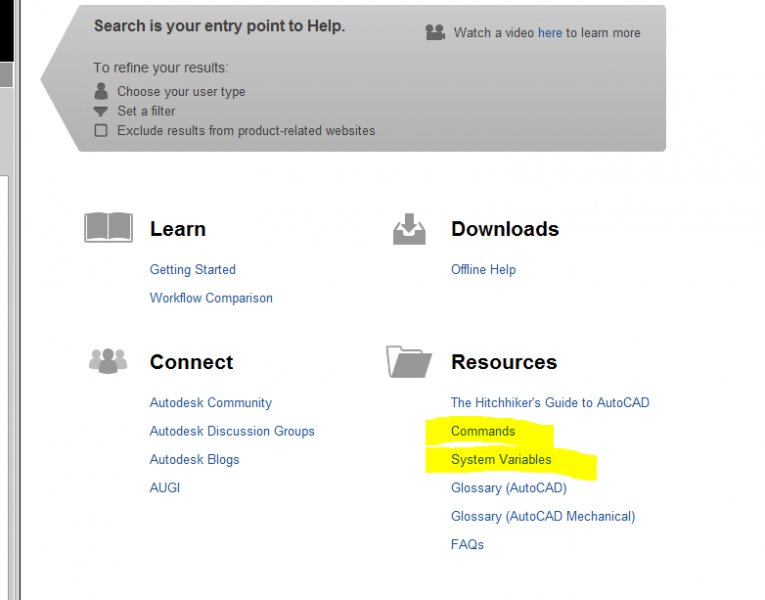

I was wondering if anybody knew how to get a list of commands and variables in AutoCad 2013. In the past I always got that from the help files, but it seems now that I cannot find in the help files in this new version of AutoCad 2013.

Get the off line help file, in options set to use off line help, because the lists are in the off line help.
I have the offline help, and I cannot find in there the whole list of commands.
]Maybe it is the online help then, try that instead
For your system variables you can use the SYSVDLG command at the commandline.
