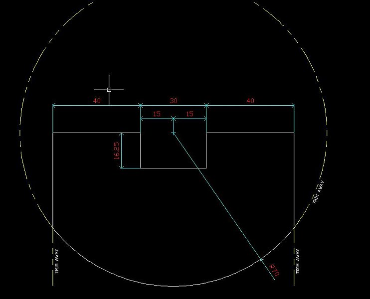

Here's where I am at the moment but I'm struggling a bit.
Bit of an Update although still stuck
Please excuse my pittyfull attempt on m/s paint.
I have no mouse. only a touch pad.
I tried to explain a little. hope it makes sense. you may have to muck around a little to get used to the commands but it will come to you.

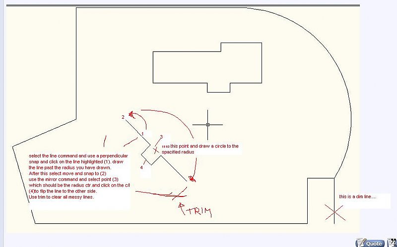

I'm pretty familiar with the commands but I'm still having trouble understanding the measurements. Thank you stevesmith for the help.
the 15 and 16.25 refer to the centre point of the radius or arc which ever you want to call it.
make some temporary construction lines to find this point and draw a circle from that point to the specified size.
Why dont you try drawing it as I have shown. and rotate the entire building 45 deg
Thanks for your help I've now done it cheers :)
You still haven't removed the line in the bottom right hand corner!!
That line (if you look at the original) is a dimension line. Not a wall.
