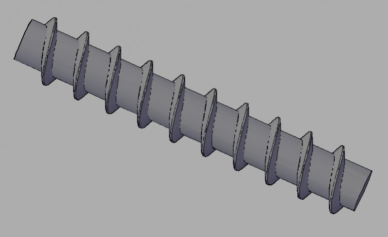

ReMark Posted February 12, 2013 Posted February 12, 2013 Caveats: 1. This is a rough approximation intended for demonstration purposes only. 2. The gear teeth are a figment of my imagination. Any relation to the real world is purely accidental on my part. This was done using plain AutoCAD. I think it would be wiser to create your worm gear using Inventor. I did it by creating a small four tooth section in profile using a continuous polyline. I copied the original profile 1/2" higher then rotated it thereby offsetting the teeth (they do not line up). I used the LOFT command to create a 3D solid. I arrayed this result and unioned everything together. Yes, it is not the most elegant way nor the quickest but you get the general idea don't you? Not to worry. JD Mather will come along, tell me where I screwed up, and suggest as he always does that I should have used a modern MCAD program (like Inventor). Heard it all before and I just don't care. For me it was just a fun exercise. If you gain something from it fine. If you don't well what can I say? No offense taken. We cool? Quote

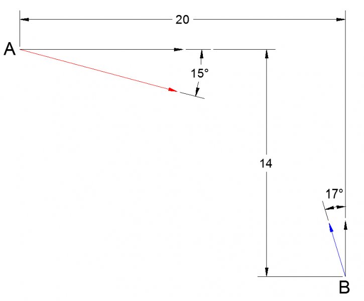

spinecad Posted February 13, 2013 Author Posted February 13, 2013 And how to draw a curve that tangent to red line and blue line from point A to point B such as below image in AutoCAD? I'd tried this in Solidworks and Catia which are much easier than in AutoCAD. Perhaps in the next version of AutoCAD I hope. Quote
SEANT Posted February 13, 2013 Posted February 13, 2013 And how to draw a curve that tangent to red line and blue line from point A to point B such as below image in AutoCAD? I'd tried this in Solidworks and Catia which are much easier than in AutoCAD. Perhaps in the next version of AutoCAD I hope. Attached via the Spline command, Method = CV, Degree = 2. Tangents.dwg Quote

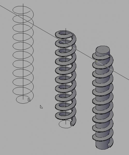

ReMark Posted February 13, 2013 Posted February 13, 2013 One of those two parts: I see said the blind man. Those can be drawn using the HELIX and SWEEP commands. Quote
ReMark Posted February 13, 2013 Posted February 13, 2013 A rough approximation but I think it serves the purpose. Use the HELIX command to create the spiral. Draw your tooth profile. Sweep the profile. Extrude the core. Union together. Done. Quote

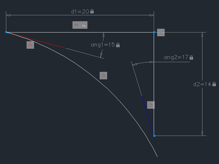

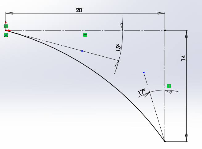

JD Mather Posted February 13, 2013 Posted February 13, 2013 (edited) And how to draw a curve that tangent to red line and blue line from point A to point B such as below image in AutoCAD? I'd tried this in Solidworks and Catia which are much easier than in AutoCAD. Perhaps in the next version of AutoCAD I hope. Use Constraints (Parameters tab in AutoCAD since v2010 or 2011). Attach your SolidWorks file here. By "curve" do you mean an arc (part of a circle) or a spline? There is no solution to an arc going through those two points and tangent to those two lines. This is through both points and tangent to ONE line. (SolidWorks) This is tangent to both lines going through ONE point. (AutoCAD) Edited February 13, 2013 by JD Mather Quote
spinecad Posted February 14, 2013 Author Posted February 14, 2013 By "curve" do you mean an arc (part of a circle) or a spline?There is no solution to an arc going through those two points and tangent to those two lines. [ATTACH=CONFIG]40251[/ATTACH] This is through both points and tangent to ONE line. (SolidWorks) [ATTACH=CONFIG]40254[/ATTACH] This is tangent to both lines going through ONE point. (AutoCAD) I mean how to create such as the first picture (Solidworks) of above two pictures in AutoCAD? I would like to create a spline that has its control point such as in the Solidworks. Quote
spinecad Posted February 14, 2013 Author Posted February 14, 2013 [ATTACH=CONFIG]40240[/ATTACH]A rough approximation but I think it serves the purpose. Use the HELIX command to create the spiral. Draw your tooth profile. Sweep the profile. Extrude the core. Union together. Done. No it's not SWEEP ing. Quote
ReMark Posted February 14, 2013 Posted February 14, 2013 (edited) It should sweep if there is no problem with your geometry. I swear I used the SWEEP command on my tooth profile. Attach a copy of the drawing to your next post. Someone here will take a look at it. Maybe they can discern what the nature of the problem is. Edited February 14, 2013 by ReMark Quote
