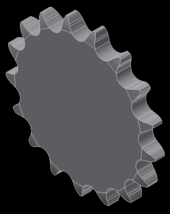

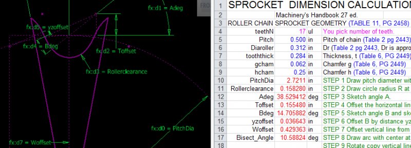

JD Mather Posted January 21, 2013 Posted January 21, 2013 ReMark said: Maybe it's time to move on to drawing something else? We could do a Roller Chain Sprocket! Quote
ReMark Posted January 21, 2013 Posted January 21, 2013 Sounds like a challenge. Let's see if the OP will be up to it. Quote
spinecad Posted January 23, 2013 Author Posted January 23, 2013 I ask how to model a tooth of a mating gear that has different size of diameter. But why do you respond how to model a sprocket? ???????????? I don't need it. Quote
