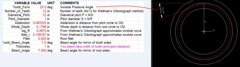

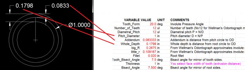

There are two ways to draw the gear (tooth), the more complex involute curve and a simplified representation using the Wellman's Odontograph method.
I will start with the Wellman's technique and make up parameters since you don't seem to have any starting information.
Let me go find my spreadsheet.
I do not have any idea of your training or experience with AutoCAD - so I will start out very basic and slow.
Once I know you are following along OK, then I will post the spreadsheet.
Draw 3 circles and one vertical line with the dimensions shown (I recommend you color-code these even though I didn't).
Attach your dwg file of what you have completed so far.
(I have to do it this step-by-step method as students frequently ask questions like this and then disappear after a couple of steps.) I am taking this information from the texbook by Giesecke, et al Technical Drawing.

Draw these two red lines at 20° angle and then draw red circle tangent to the angled line.

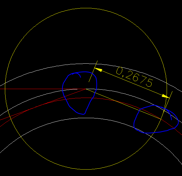

Next draw this cyan (blue) arc and yellow arc.
The centers of these arcs are on the red circle.
There is a bit of a trick to locating the center points - post back if you don't know the trick.
Post your file here when you have finished this step.

I don't know the trick.

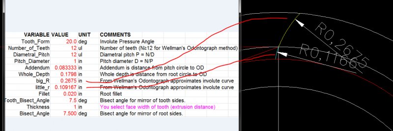

Gearb.dwg

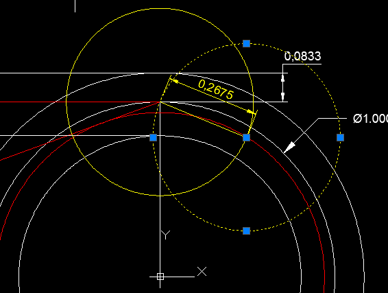

The trick is to simply draw a circle with the desired radius (in this case big_R or r.2675) with the center at a location that you do know. Where that circle passes through the reference circle is one of two possible locations for the desired centerpoint. The one of the two possible points you need is visually obvious.
Center Trick.PNG draw second yellow arc at rightmost intersection of yellow arc shown and red arc. Delete the original yellow circle and trim the second yellow circle beween the pitch circle and the addendum circle as shown in my earlier post.
Repeat for little_r
[ATTACH=CONFIG]39378[/ATTACH] draw second yellow arc at rightmost intersection of yellow arc shown and red arc. Delete the original yellow circle and trim the second yellow circle beween the pitch circle and the addendum circle as shown in my earlier post.
Repeat for little_r

Now draw circle with center at intersection of yellow circle and red circle as shown.
