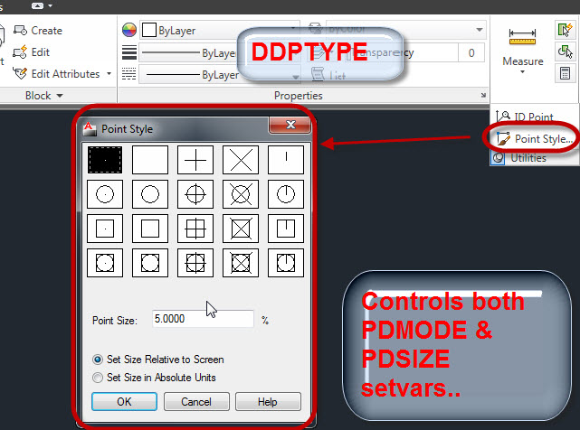

DDPTYPE is a command that lets you controls what type of Points are displayed and their size which is controlled by the PDMODE and PDSIZE system variables.
This can be launched in the command line or found on the Home tab > Utilities panel (dropdown)...
Also note that the size can be an absolute size or relative to your screen
