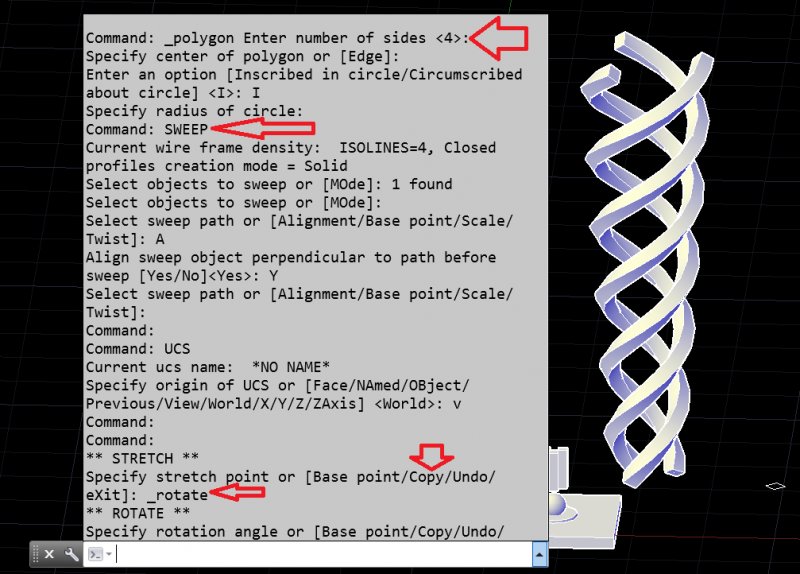

mvickers89 Posted December 16, 2012 Posted December 16, 2012 http://www.lighting55.com/antinea-floor-lamp-by-terzani.html Hey guys, My name is Matt and I am new to Autocad. Trying to get the spiral support drawn in autocad (pictured above). So far I have the base...just do not know how to make the spiral square to look like that. Lamp.dwg Any help is greatly appreciated. Trying to learn! -Matt Quote
ReMark Posted December 16, 2012 Posted December 16, 2012 Make one you've got all three as they appear to be the same. Try a sweep of a square with a twist along a helix. Quote

JD Mather Posted December 16, 2012 Posted December 16, 2012 Here are a few clues - (I didn't take the time to try to make it look exactly like your picture). Quote
