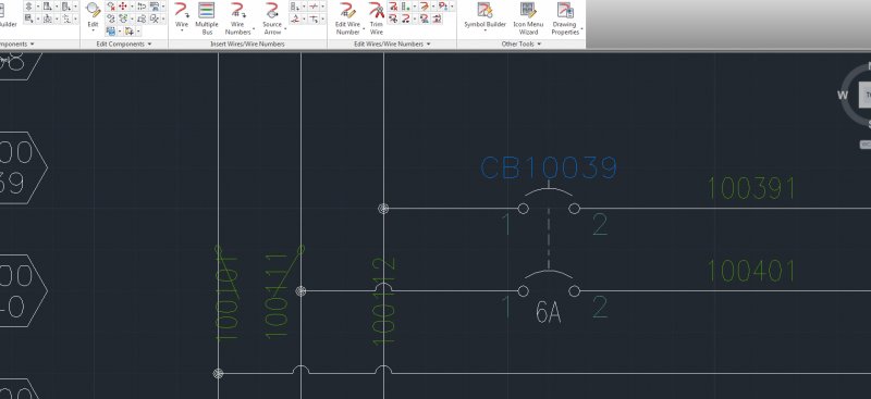

Okay, another wire number question...
I currently have my wire numbers set up so they are supposed to align with the wires.
Unfortunately, I'm running into a problem with the vertical wire numbers being placed in odd positions and sometimes with leaders (see attached image). The horizontals are working just fine, though.
I've gone through everything I can think of, and have no further place to go to try to get this straightened out.
Any assistance would be helpful.

have you tried going to the drawing properties and forcing leaders to "never"?
::smacks forehead::
Duh! I can't believe I didn't think of that...
Thanks man!
