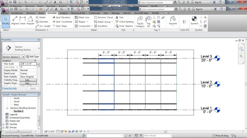

I would like to create tunnel for vehicle and i want to create under groung tunnel for metro and other vehicle.
My client asking me that he can use Revit Structure for Tunnel design and tunnel structure.
also have attached a file of curved beam detailing. can we give curved beam rebar detailing in revit Structure and how?
he has given me tunnel profile i am attaching dwg file kindly see.

Revit Structure is more than capable of designing the examples shown in the DWG files. Just use a normal Extrusion on a profile, then use the Rebar tool to place all your reinforcements. Align some of the beams and done.

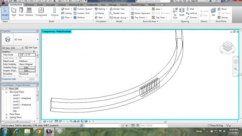

Hi,
I am trying to give the reinforcement details and facing lots of problem you have some tutorials or vedio to give curved reinforcement detail in Beam.

I am not REVIT savvy, but Stykface certainly is, and he has given a brief overview of the
techniques one might want to use to accomplish this using Revit in his post.
Hi, I am trying to give the reinforcement details and facing lots of problem you have some tutorials or vedio to give curved reinforcement detail in Beam.
Use the Detail Line or Model Line tool to create your Arc:
Start the Beam tool. Use the Pick Lines option:
Now select the line. Easy as pie. :)
As for your Rebar, you can use the Rebar tools but my suggestion would be simply to just draw it in with 2D Linework once you've got your sections and other Views set up. Revit doesn't have to be 100% 3D all the time. Just utilize the 3D functionality the best you can then polish it off with 2D Linework. As you get more familiar with the program, you'll start attempting more sophisticated tools that Revit has to offer.

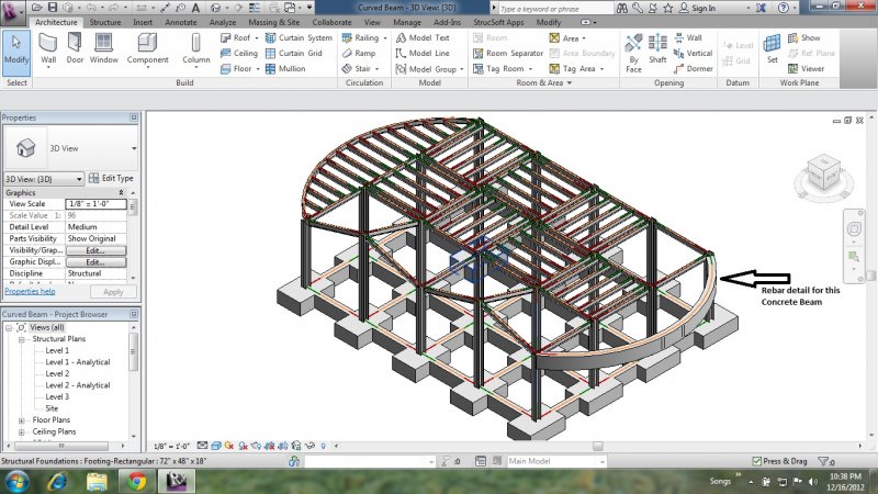

Thanks dear,
but I am talking about concrete beam as per AutoCAD Drawing which I uploaded. I have Draw Beam but Unable to give Rebar Detail in curved concrete Beam.

I just explained to not worry about the reinforcement. If you want to attempt it, then that's fine, but use the Sketch method instead. Revit Help has a lot of detailed explanation regarding Rebar. But, once again, I'll suggest to not worry about the Rebar Tool as it will only cause major problems and frustrate you, due to the nature of this type of design. You have to crawl before you can walk and you're attempting some very complicated reinforcement tasks.
Dear,
Kindly see attached file. I want to give rebar detail in curved concrete beam.

If all you're doing is using Stirrup Rebars then just use the Maximum Spacing option so it spans all the way across the beam. :)

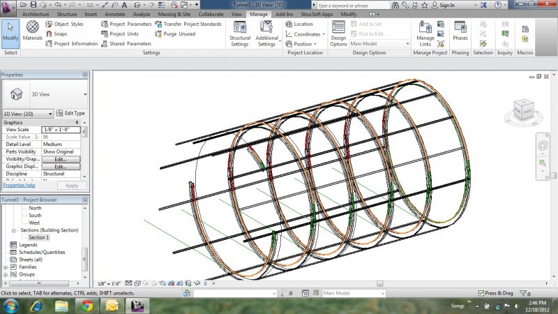

Hi,
I want to create Truss in my Circular Beam. How can i do this???

I'd be at a loss if you're trying to literally use the Truss Tool. I'm no pro by any means. I would suggest just modeling it on a manual basis to start with.
