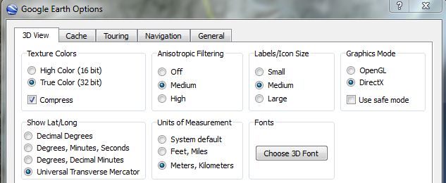

eldon Posted December 13, 2012 Share Posted December 13, 2012 I am not sure that it is Universal Transverse Mercator coordinates, because the most Southern part of Israel (near Aqaba) has the UTM coordinates of 686426 mE, 3263478 mN. The Eastings match up but the Northings may be offset. Besides that, have you tried showing UTM coordinates on Google Earth? On the tool bar, click on Tools, then Options which gives you the option of setting the coordinate display in several formats. Quote Link to comment Share on other sites More sharing options...
