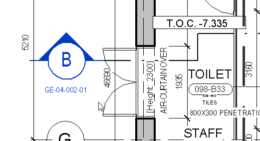

irneb Posted December 14, 2012 Posted December 14, 2012 Here's the problem section head. What I ended up doing was create 4 different types (Pointing Left, -Right, -Up and -Down), you needed to use the correct one depending on the direction in which the section pointed. Though it still had issues with diagonal sections. But wors was that no matter what I did, a section line indicated on a section / elevation would draw ALL its text horizontally. And due to the design of this section - the sheet number needs to be vertical. Quote
tzframpton Posted December 14, 2012 Posted December 14, 2012 Ah, I see. So in the first image, you can't create a separate Section Head Type, and rotate the Sheet Number Label? Also, another workaround, would be to use a Label with Opaque Text and just have everything oriented in a horizontal position, and in a position where the arrow that surrounds the callout bubble doesn't interfere no matter what rotation it is. The Opaque text will mask the section line if it ever goes through it. Yes, Revit doesn't allow 100% free-to-the-hearts-desire abilities with certain objects, but my stance would be that it's simply a comprise for using a better product that leverages parametric capabilities which the advantages far outweigh vanilla AutoCAD capabilities. Just my very humble $0.02, of course. Quote
