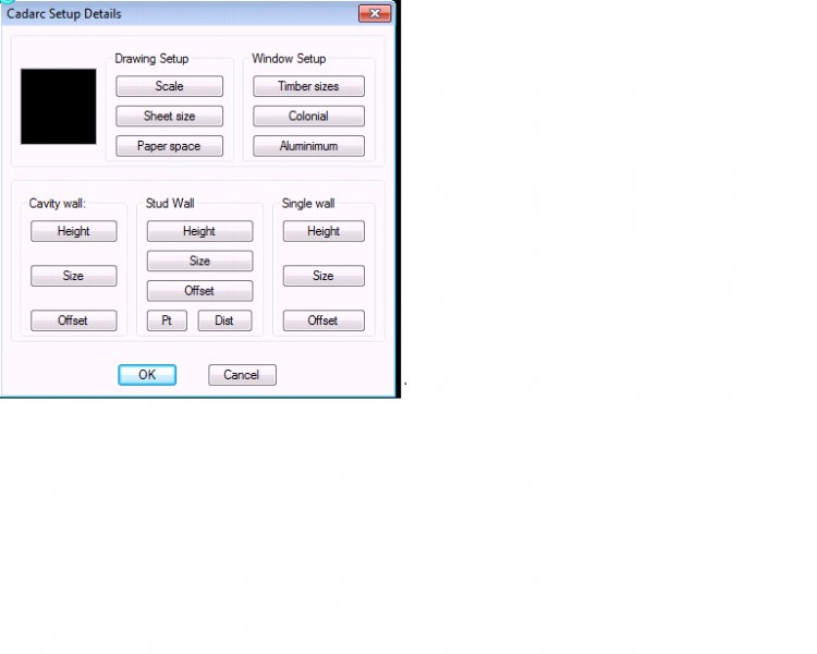

An example click a tab and it opens up trying to find how to explain simply it has multiple dialogs that open when parent is clicked. It copyrited so can not post code.
