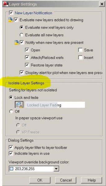

Dadgad Posted December 13, 2012 Posted December 13, 2012 Check your LAYER ISOLATE SETTINGS, as shown in the image. You can access them with the wrench icon in the upper right hand corner of the LAYER PROPERTIES MANAGER. I am guessing that will get you back on the tracks. If it doesn't, you may find that the REFRESH button, which is to the left of the wrench icon may reset them for you. Quote

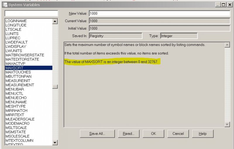

lh2os Posted December 13, 2012 Author Posted December 13, 2012 Unfortunately that didn't fix my problem. Although it is good to know how to change those settings, thanks for that. The layer visibility is set up the way I want it when I isolate the layers. I have them set to "off" when I isolate. When I unisolate the layers many remian "off" and I have to go into the layer properties manager click on a layer, press ctrl "A" and click the light bulb to turn them all back on. I have 1298 layers in this particular drawing between my own and xrefs. I haven't counted the number of layers that remain off, could it be a setting similar to "maxsort" in that AutoCAD for some reason can't handle the large number of layers? Quote

Dadgad Posted December 13, 2012 Posted December 13, 2012 Unfortunately that didn't fix my problem. Although it is good to know how to change those settings, thanks for that. The layer visibility is set up the way I want it when I isolate the layers. I have them set to "off" when I isolate. When I unisolate the layers many remian "off" and I have to go into the layer properties manager click on a layer, press ctrl "A" and click the light bulb to turn them all back on. I have 1298 layers in this particular drawing between my own and xrefs. I haven't counted the number of layers that remain off, could it be a setting similar to "maxsort" in that AutoCAD for some reason can't handle the large number of layers? It sounds to me like you may well have hit the bullseye with that hypothesis. Well done. The default value is 1000, check the attached image for more. Quote
lh2os Posted December 13, 2012 Author Posted December 13, 2012 Sorry I should have mentioned that I have already changed the "maxsort" variable to accomodate the number of layers I have. How about maybe a "layer state manager" issue? I'm not sure how the layer state manager works, but is it possible that the layers are reverting back to a previously saved state? Quote
Dadgad Posted December 14, 2012 Posted December 14, 2012 Where are you encountering this issue, in MODELSPACE or PAPERPACE? You might try turning off the NEW LAYER NOTIFICATION in the LAYER SETTINGS, as shown in my earlier post. and see if that does it. Quote
lh2os Posted December 14, 2012 Author Posted December 14, 2012 Turning off NEW LAYER NOTIFICATION didn't fix the problem. When I isolate a layer in PAPERSPACE - no problem In MODELSPACE using the tab - no problem In MODELSPACE through the viewport is when layers remain off. I checked to see if it was consistant between sheets in the drawing set (12 in total right now) and the answer is yes and no. Yes layers remain off but it is a different number of layers on every sheet. One sheet had 196 layers that remained off while another had 208. Is that a layer state manager overriding my layer visibility? Quote
Dadgad Posted December 14, 2012 Posted December 14, 2012 In light of this behavior, try changing the DIALOG SETTINGS in your LAYER SETTINGS (you can see them in the image in post #7), so that both of them are UNCHECKED. That should clear the filtering from your layer dropdown menu in paperspace. Quote
