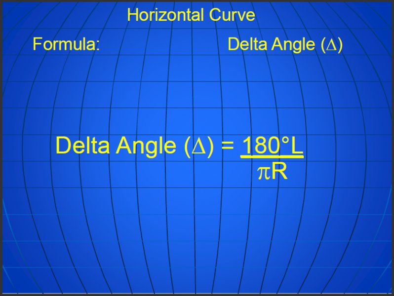

SLW210 Posted December 11, 2012 Share Posted December 11, 2012 Arc Length/Radius = Angle (in Radians). (Radians x 180)/Pi = Angle in Degrees See if THIS helps. Quote Link to comment Share on other sites More sharing options...
ReMark Posted December 11, 2012 Share Posted December 11, 2012 Source: Math for Surveyors. Quote Link to comment Share on other sites More sharing options...

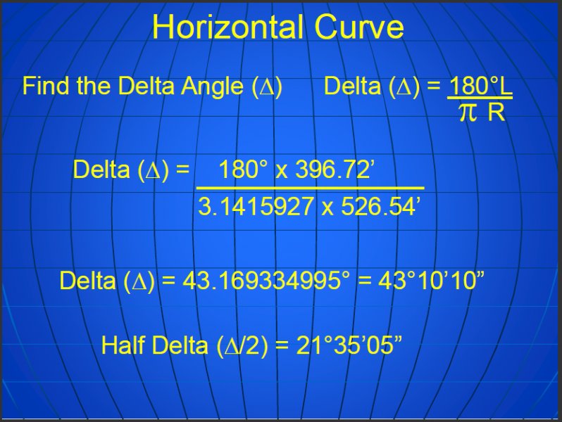

ReMark Posted December 11, 2012 Share Posted December 11, 2012 An example demonstrated. Source: Math for Surveyors - ESRI Proceedings. Quote Link to comment Share on other sites More sharing options...
