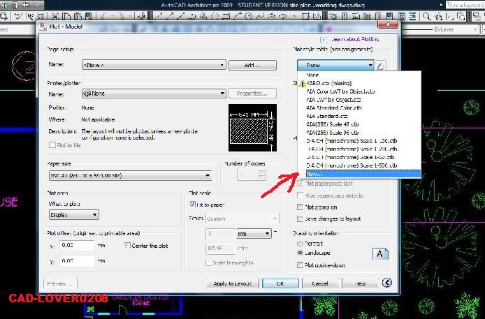

First time poster... all of the pen tables have gone missing from my plot manager. i used to have a selection ie. monochrome, grayscale etc ...
Now it says, none or new. When I click new, it opens a dialogue box to create new pentables or browse a file. CTB files are not part of the options, which is confounding. It's worked for me before....
As well, i've got a ctb file from school that will not show up, even tho i've done all the steps as shown in class...
we saved it, go under file, click plot style manager and paste....i see it in the file, but when i go to plot, it is "missing"

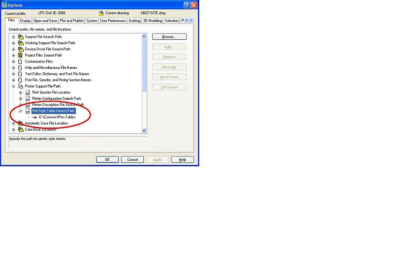

Be sure the .ctb files are in the folder specified in the Plot Style Table Search Path.

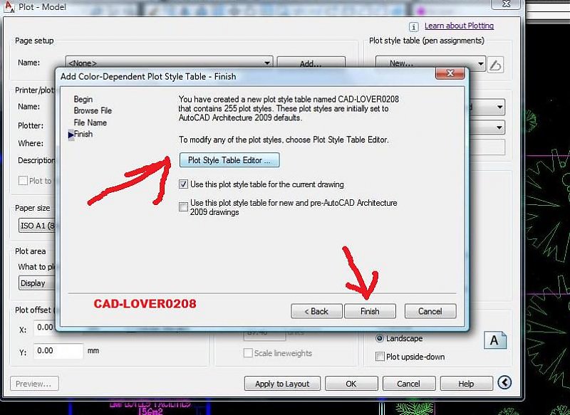

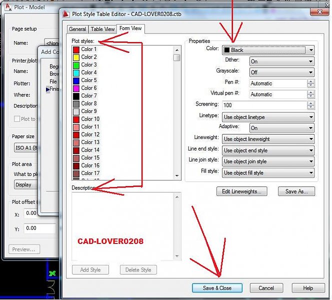

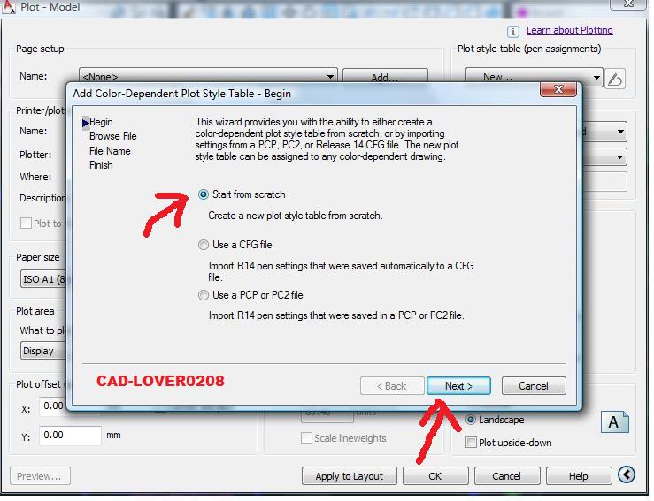

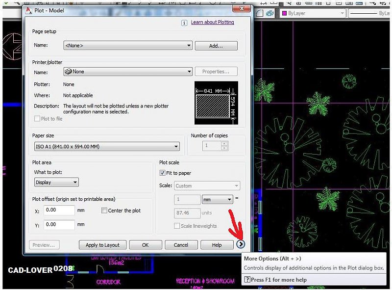

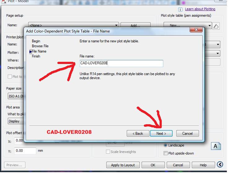

i've had this problem before... STB were stuck in my DWG and whenever i print, i get really light line wights because of the STB files... untill someone helped me and told me to do the following :
---> Click on File
---> New
---> Aec Model (Metric Ctb)
---> a blank dwg will open
---> then go to INSERT
---> block
---> choose your dwg
---> click ok
---> then again ok
---> then type 0,0,0 ENTER and you will see your dwg. in the new model layout.
---> then celect all
---> type explode
---> enter
Then when you want to print go to file
---> plot
---> check the images i added here i hope they are helpful..
