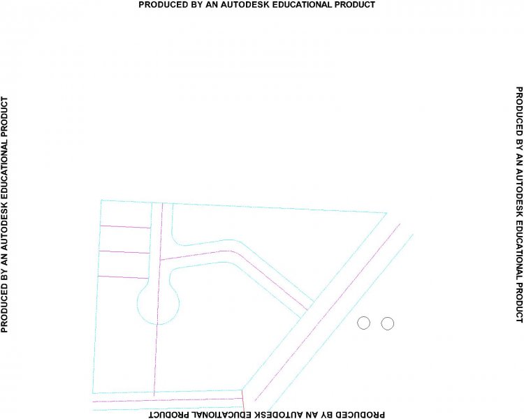

marksay Posted June 28, 2013 Posted June 28, 2013 :unsure:Here is what I have so far, I need to go back to your details on FILLETS on the bends. I think all of my FILLETS are wrong but know for sure the cul-de-sac Fillet is for sure. Quote
marksay Posted June 28, 2013 Posted June 28, 2013 Also need to figure out how to upload it with black back round.. Quote
