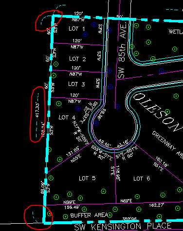

kamila Posted February 18, 2013 Posted February 18, 2013 hi, it looks like i am going to have more questions. i am already so tired of this project. right now i cant figure out those dashed line for total length. "locate two small dashed arcs on the drawing"???where are they? "draw the text describing the boundaries..."??? please, help... Quote
ReMark Posted February 18, 2013 Posted February 18, 2013 The short dashed line segments would appear at each end of a boundary line. The distance of the boundary line would then be centered between the ends of the line. Ex. ------ 234.56 ------ Got it? Quote
kamila Posted February 18, 2013 Posted February 18, 2013 no . does it supposed to come out be itself? do i have to make it? could you give me some directions how to do it? Quote
ReMark Posted February 18, 2013 Posted February 18, 2013 This is what one student did. Pay particular attention to the objects circled in red. Quote

kamila Posted February 25, 2013 Posted February 25, 2013 hi, i got it. but i have another problem and i dont know what is wrong. few times all the lines changed to continuous. i fixed it but i dont know how. suddenly the ltscale is 1 for some of the lines to come back to what they supposed to be, but not all of them. when i change ltscale to 50 they cont again. what did i do wrong again? everything was fine so what happened? help me, please. its been over 3 weeks now and i am ready to quit Quote
ReMark Posted February 25, 2013 Posted February 25, 2013 The linetype scale does not change all by itself. Quote
