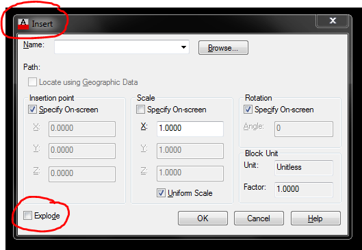

ReMark Posted December 18, 2012 Posted December 18, 2012 Check your INSERT command. Look in the lower left-hand corner. See where it says Explode? If there is a check mark there then remove it! I wish you had used the Tree-Oleson block I provided for you. Quote
AutoCad Student Posted December 18, 2012 Author Posted December 18, 2012 I had already determined that the explode box was checked, but how do I now go back and unexplode each tree? I tried unchecking it but it didn't seem to help. UGH! I also entered your tree block to see if it would show up on the BEDIT block and it doesn't either. No matter what I do I cant get either tree block to show up in BEDIT. Quote
