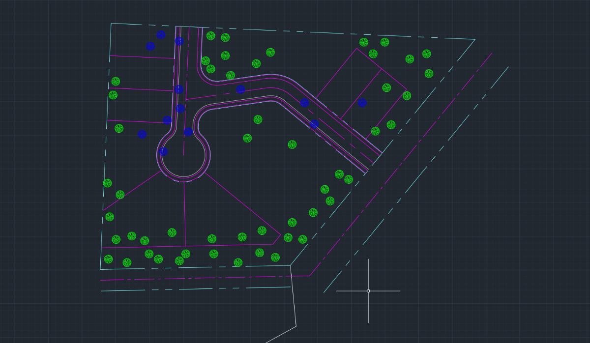

UlyssesJones Posted May 27, 2024 Posted May 27, 2024 This is my drawing thus far, ive been skipping labeling things and ive gotten to the part of this packet named "Surrounding Area". After entering all the trees, Im overthinking the layers involved. i clicked several as i went and added them all to their respective layer, "trees save" or "trees remove", I was just curious if thats the correct way to go about it. Im really second guessing the expectations on the outcome here with labels, layers, how to know what size font to make each specific thing, things like that. If anyone had a more finished example to share of the end result thatd be amazing. Id like to have something to reference as i go along and check whether or not im even doing any of this right to begin with. Thanks for anyone who helps i really appreciate it. I hope the rest of these projects arent like this one, this has been like relearning english trying to understand these instructions on my own from PF Quote
ReMark Posted May 27, 2024 Posted May 27, 2024 Typically, one would create all the necessary layers first then, depending on what is being created, make that layer current. Font sizes are called out in the project instructions. 1 Quote
UlyssesJones Posted May 27, 2024 Posted May 27, 2024 On 5/27/2024 at 11:20 AM, ReMark said: Typically, one would create all the necessary layers first then, depending on what is being created, make that layer current. Font sizes are called out in the project instructions. Expand Thank you for the reply! I appreciate the advice. The fonts I found the names for and my layers are coming together as they should I think. I think I'm near the end here but I'm sure I'll be back as I've been referencing this post a ton, this has been immensely valuable for this project. Quote

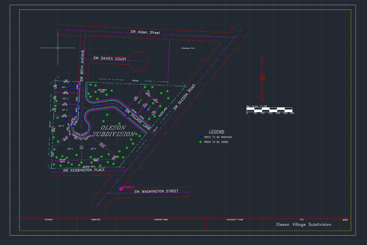

UlyssesJones Posted May 29, 2024 Posted May 29, 2024 I'm rereading the directions over and over just to make sure i got everything in the drawing that needs to be there. The one question i definitely have is at the end of the instructions after moving the border block so it surrounds the plat map, it then says to use the zoom extents option so the entire drawing will fill up the screen. At the very beginning of this im positive i set the limits of the drawing the that original rectangle size of 2000000,2000000. Is this going to be an issue if i submit it like this, or am i overthinking it at this point. thank you for your help Quote
ReMark Posted May 29, 2024 Posted May 29, 2024 No, it won't be a problem as long as the instructor is familiar with the project, which he/she should be. Quote
