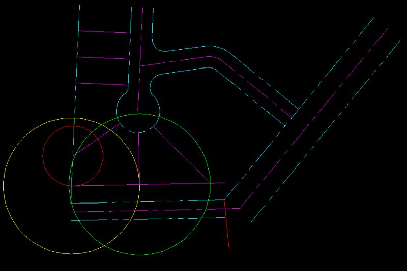

hollykemp Posted October 26, 2023 Posted October 26, 2023 On 12/7/2012 at 9:49 PM, ReMark said: It must be your lucky day. Had a few minutes to whip this up. Laying out lots #4, 5 and 6. I used circles to find intersection points then ran a line from the intersections back to the center of the cul-de-sac. Lot #4 - red circle. Copy the north streetline of SW Kensington Street to the intersection of the west boundary line of lot #4 and the south property line. This will give you the south property line of lots #5 and 6. This line is the north edge of the buffer area between the back of the lots and SW Kensington Street. Lot #5 - yellow circle. Lot #6 - green circle. OK...gotta go. Catch up with you on Saturday. Good night. Addendum: I messed up on lot #6. See the image attached to post #47. There should be a small segment of property line (23.06 feet) going off in a northeasterly direction. My apologies. Expand Where did the radius of these circles come from? This is making a lot of sense until here. Stuck on how to do boundary for lot 5 and 6. Quote

ReMark Posted October 27, 2023 Posted October 27, 2023 On 10/26/2023 at 10:56 PM, hollykemp said: Where did the radius of these circles come from? This is making a lot of sense until here. Stuck on how to do boundary for lot 5 and 6. Expand The streetline to the south has a radius of 30.00 while the streetline to the north has a radius of 80.00. Quote
