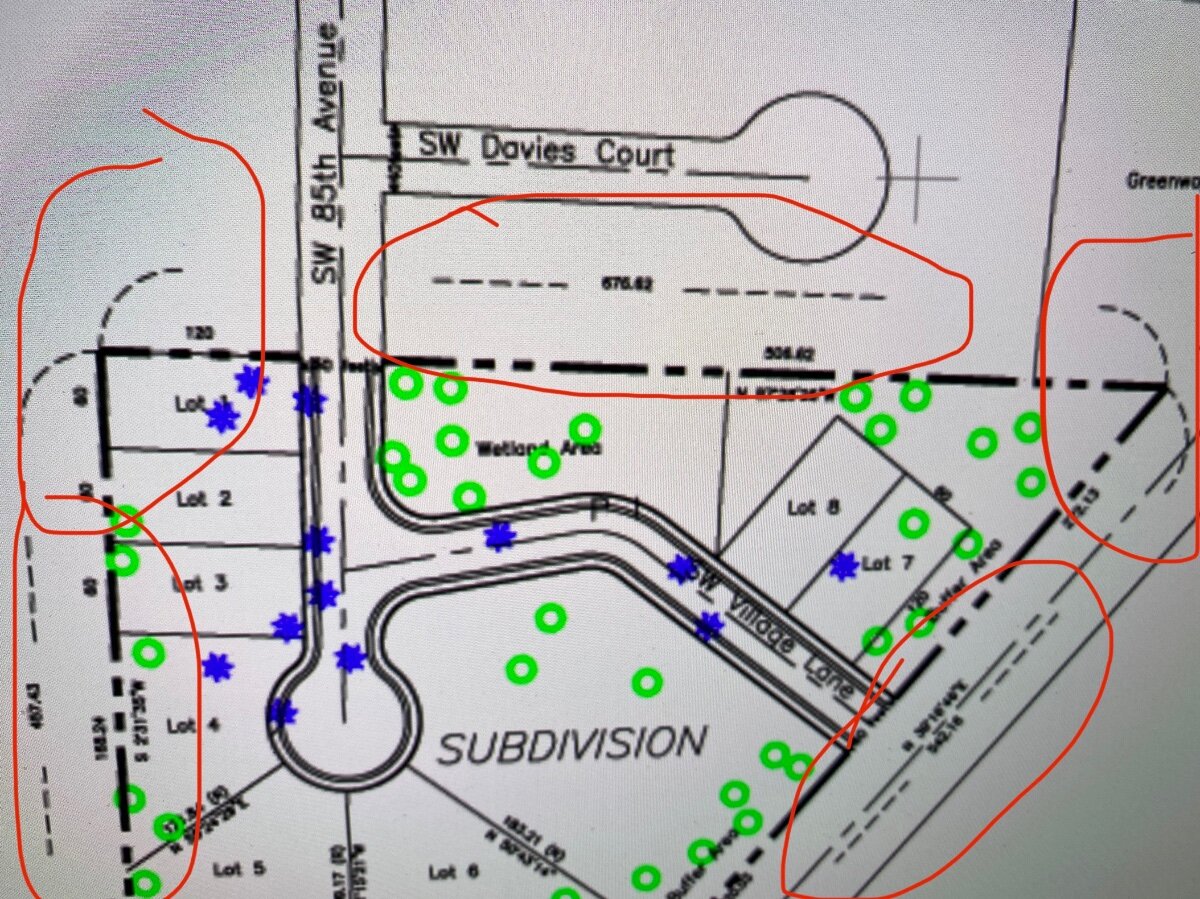

ReMark Posted February 24, 2022 Posted February 24, 2022 On 2/24/2022 at 1:16 PM, patti0916 said: Hello all. Can anyone offer some guidance on drawing the corner arcs and dimensions? Expand Re: corner arcs. You mean the arcs associated with the cul-de-sacs on SW Davies Court & SW 85th Avenue? Re: dimensions. Which dimensions specifically are you talking about? Quote
ReMark Posted February 24, 2022 Posted February 24, 2022 (edited) Comment removed by author since it did not pertain to question. My apologies. Edited February 24, 2022 by ReMark Quote
patti0916 Posted February 24, 2022 Posted February 24, 2022 On 2/24/2022 at 5:43 PM, ReMark said: Re: corner arcs. You mean the arcs associated with the cul-de-sacs on SW Davies Court & SW 85th Avenue? Re: dimensions. Which dimensions specifically are you talking about? Expand See attached picture Quote
ReMark Posted February 24, 2022 Posted February 24, 2022 (edited) AutoCAD gives you several options for creating Arcs... pick one. Or, you can draw a circle then using both a property line and a temporary line trim it to look like an arc. Erase temporary line. Done. Re: dimensions. In this case dimensions are just single line text. Make sure the text (i.e. - dimensions) runs parallel to the property line it refers to. Edited February 24, 2022 by ReMark Quote
patti0916 Posted February 24, 2022 Posted February 24, 2022 On 2/24/2022 at 6:10 PM, ReMark said: AutoCAD gives you several options for creating Arcs... pick one. Or, you can draw a circle then using both a property line and a temporary line trim it to look like an arc. Erase temporary line. Done. Re: dimensions. In this case dimensions are just single line text. Make sure the text (i.e. - dimensions) runs parallel to the property line it refers to. Expand Thank you, I’ll give it a go! Quote

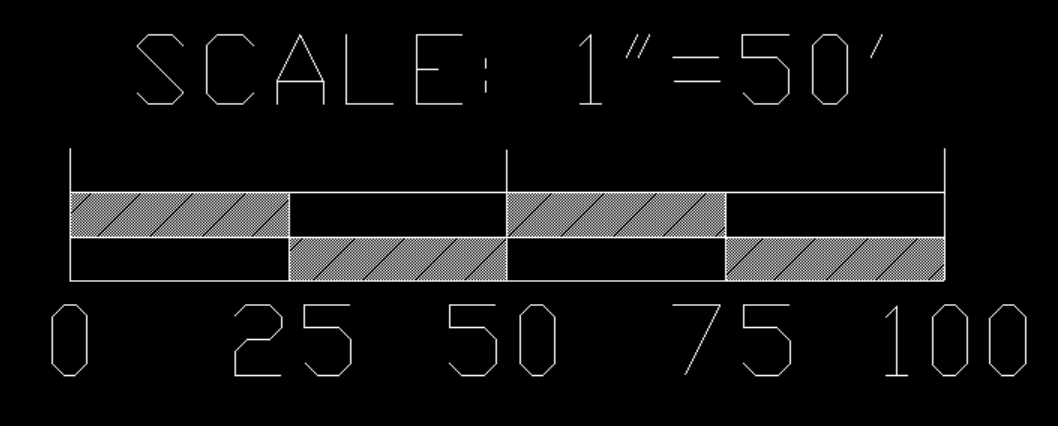

ReMark Posted March 14, 2022 Posted March 14, 2022 Tay: This is an example of what a scale bar might look like. Quote

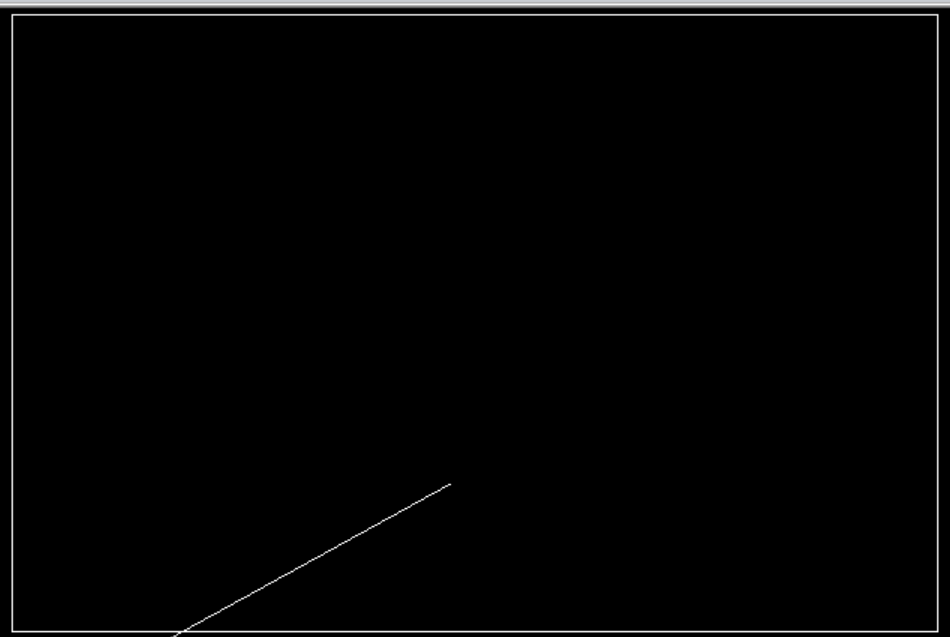

ReMark Posted September 5, 2022 Posted September 5, 2022 (edited) Here are two images that might be of benefit to you. The first image (Oleson Subdivision_1) is of the line and the rectangle I instructed you to create in my previous post. I've drawn a circle around the end of the line in yellow. Do you see it? It's way off at the far end of the line and quite frankly very near impossible to see. The second image (Oleson Subdivision_2) is a close-up of the far end of the line surrounded by the rectangle. This is what I had circled. If you follow Penn-Foster's suggestion and specify your limits as 0,0 and 2000000,2000000 your subdivision will be even more difficult to find as the area it will exist in will be significantly larger. Oleson Subdivison_1: Oleson Subdivision_2: Edited September 5, 2022 by ReMark Quote
