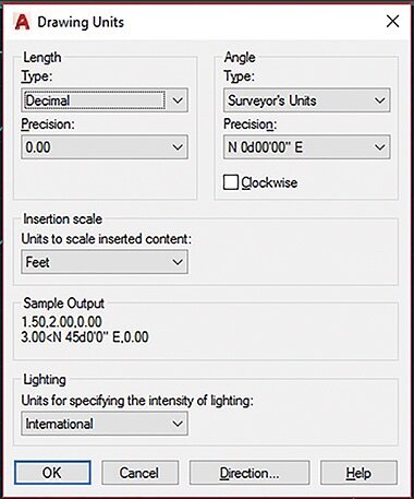

patti0916 Posted February 3, 2022 Posted February 3, 2022 On 12/5/2012 at 12:30 PM, ReMark said: Oleson Village - Units. Expand ReMark, Do you feel like these drawing units for today’s project are correct? In the instructions the units to scale are noted as “feet”. ‘Thanks! Quote
ReMark Posted February 3, 2022 Posted February 3, 2022 On 2/3/2022 at 2:55 AM, patti0916 said: ReMark, Do you feel like these drawing units for today’s project are correct? In the instructions the units to scale are noted as “feet”. ‘Thanks! Expand Yes, I do. Quote
patti0916 Posted February 3, 2022 Posted February 3, 2022 On 2/3/2022 at 12:27 PM, ReMark said: Yes, I do. Expand Thanks, this is per PF instructions, so I’m a bit confused. Quote
ReMark Posted February 3, 2022 Posted February 3, 2022 My answer hasn't changed. AutoCAD is unitless. 1 unit can be equal to anything. 1 inch, 1 foot, 1 mile, 1 league, 1 furlong, 1 fathom or 1 lightyear. 1 Quote

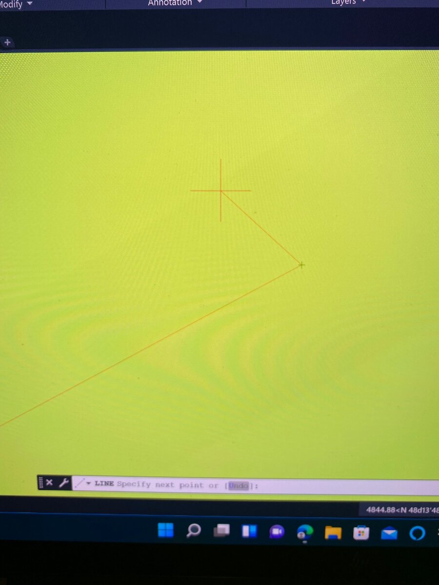

patti0916 Posted February 3, 2022 Posted February 3, 2022 On 12/5/2012 at 12:51 PM, ReMark said: Drawing the POB line. Orthomode should still be disabled (off). Start the Line command. Pick the endpoint of the reference line. Let go of the mouse. For the next point type, at the command line, @113.66 Assuming the line is there how do we verify the length and distance? Answer: we use the List command (one of a couple of options). Type List at the command line then press Enter. When asked to select object pick the line that was just drawn. Press Enter. A text window should appear listing all the information about the line. Check that the length and angle are correct. Expand I’m so confused here ReMark, I’ve got my Benchmark point and when I come off of that endpoint and enter at the command line @113.66 and enter again nothing changes. Can you help, I’m sure it’s something very stupid. Thanks! Quote
ReMark Posted February 3, 2022 Posted February 3, 2022 It appears you did not enter the angle (N5d 27' 23"W) which is shown in the next post after the one you are quoting from and underlined in red. The input would look like this: @113.66<N5d27'23"W Quote

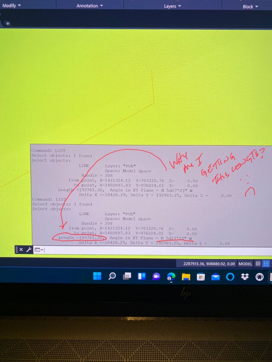

patti0916 Posted February 3, 2022 Posted February 3, 2022 On 2/3/2022 at 11:16 PM, ReMark said: It appears you did not enter the angle (N5d 27' 23"W) which is shown in the next post after the one you are quoting from and underlined in red. The input would look like this: @113.66<N5d27'23"W Expand Thank you! I’ve tried so many ways to get this point to snap, anyway I enter I come up empty. So frustrating! I’ve tried with and without the angle added. Quote
patti0916 Posted February 4, 2022 Posted February 4, 2022 On 2/3/2022 at 11:39 PM, patti0916 said: Thank you! I’ve tried so many ways to get this point to snap, anyway I enter I come up empty. So frustrating! I’ve tried with and without the angle added. Expand I got the angle correct now but not my length? Quote
ReMark Posted February 4, 2022 Posted February 4, 2022 First of all, looking at the printout of the coordinates above you started at the wrong point. The starting point is supposed to be 1421334.92, 783207.62. Your starting point's coordinates are 1421324.12, 783320.76. So, first, erase the lines you drew. Next, make sure Orthomode is enabled. Now, start the Line command, and when you are asked to Specify first point set your mouse aside and type in the correct coordinates [should look like this: 1421334.92, 783207.62] then press the Enter key. STOP. Drag your mouse to the left, let go, and where it says Specify next point on the command line type in 10.73. STOP. Drag you mouse up, let go, and where it says Specify next point on the command line type in 113.15 followed by pressing the Enter key twice. The coordinates for the end point of the line you have just drawn should be 142134.19, 783320.77. This is the starting point for drawing the four-sided boundary of Oleson Village. Quote

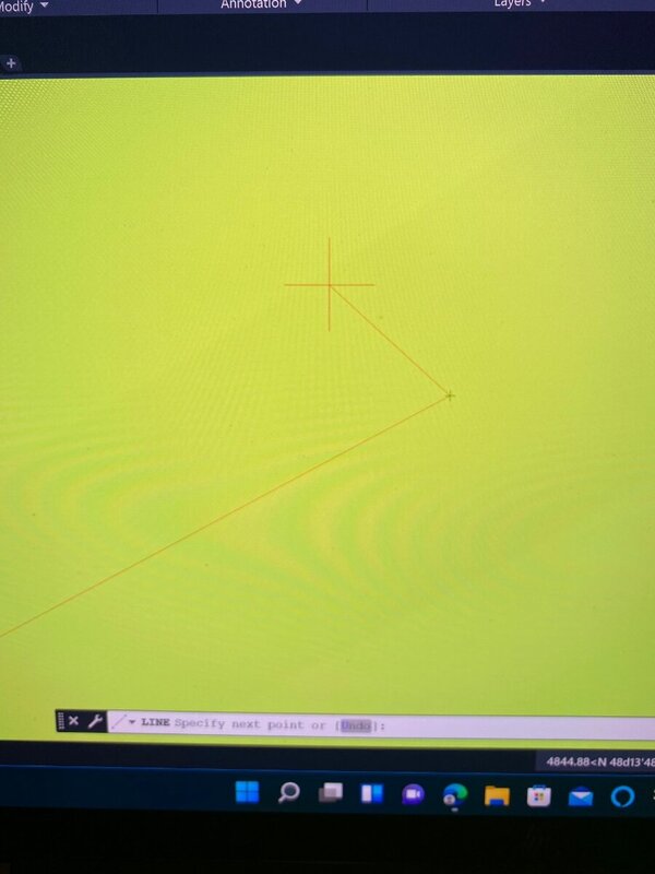

patti0916 Posted February 5, 2022 Posted February 5, 2022 On 2/4/2022 at 12:12 PM, ReMark said: First of all, looking at the printout of the coordinates above you started at the wrong point. The starting point is supposed to be 1421334.92, 783207.62. Your starting point's coordinates are 1421324.12, 783320.76. So, first, erase the lines you drew. Next, make sure Orthomode is enabled. Now, start the Line command, and when you are asked to Specify first point set your mouse aside and type in the correct coordinates [should look like this: 1421334.92, 783207.62] then press the Enter key. STOP. Drag your mouse to the left, let go, and where it says Specify next point on the command line type in 10.73. STOP. Drag you mouse up, let go, and where it says Specify next point on the command line type in 113.15 followed by pressing the Enter key twice. The coordinates for the end point of the line you have just drawn should be 142134.19, 783320.77. This is the starting point for drawing the four-sided boundary of Oleson Village. Expand Thanks so much ReMark. After entering 10.73 should I hit space bar or enter? After I go through all the steps and get to 113.15 and enter twice, my screen goes blank. Quote
ReMark Posted February 5, 2022 Posted February 5, 2022 (edited) No, do not hit the spacebar or the Enter key after typing 10.73 because you want to continue drawing a line vertically 113.15. I don't know why your screen would go blank. Try issuing a Zoom, Extents command sequence and see what happens. How much AutoCAD practice time have you had before taking on the Oleson Village project? I think you may be missing some of the basic fundamentals of using the program. You shouldn't be having this much difficulty right at the start of the project. Edited February 5, 2022 by ReMark Quote
