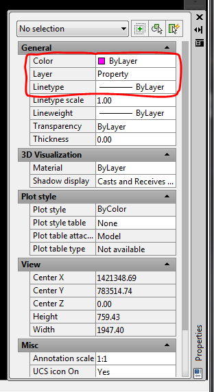

ReMark Posted December 6, 2012 Posted December 6, 2012 The Properties palette. Dock it on the right hand side of your screen. Use the Auto-Hide feature so the palette will shrink to a vertical bar when not in use. That is activated by the opposite pointing arrowheads with the vertical bar to the right (upper right hand corner of the palette). Got it? The three most important pieces of information I would like you to pay attention to are circled in red. They are: Color (Bylayer), Layer, and Linetype (Bylayer). Do NOT override the color or linetype designations. That is generally a bad drafting practice and should be avoided as much as possible. Now, back to our subdivision. I hope you are somewhat familiar with the Offset command because that is what can be used to create lots 1, 2 and 3. Quote

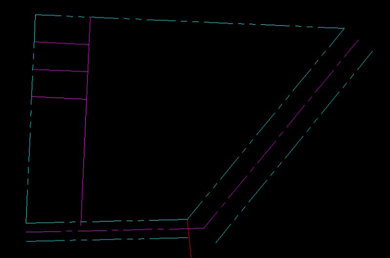

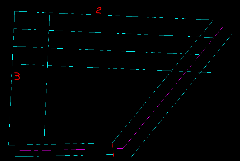

ReMark Posted December 6, 2012 Posted December 6, 2012 Offset line 2 as called for in the instructions a distance of 60. Then offset the resultant new line the same distance and repeat one more time. Offset line 3 a distance of 120. Your drawing should look similar to the above image. Trim the three lines that run east and west. Do not trim the line running north and south. These lines serve a dual purpose. They are streetlines that define the width of the right-of-way; they are also property lines. Quote
ReMark Posted December 6, 2012 Posted December 6, 2012 (edited) After you have trimmed the lines I want you to change them to the correct layer. Highlight all three lines. Go to your Properties palette and where you see the entry for Layer: Boundary change it to Property. This assumes of course that you have already created a layer called Property, with a continuous linetype and color of magenta as called for in the instructions. Now your drawing should look like the above image. Do you think you can create the remaining subdivision lots on your own? Note: refer to the Oleson Village thread I gave you a link to previously (post #10 of this thread). Take a look at post numbers 82, 83, 84 and 96. Have you had any manual drafting experience? Just curious. Edited December 6, 2012 by ReMark Quote

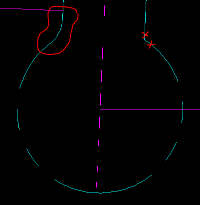

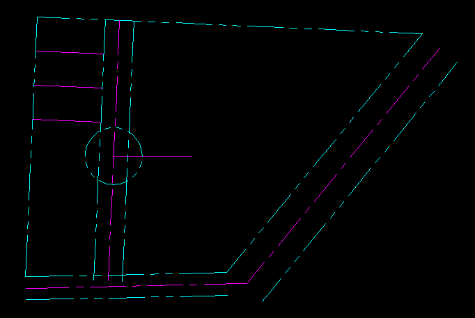

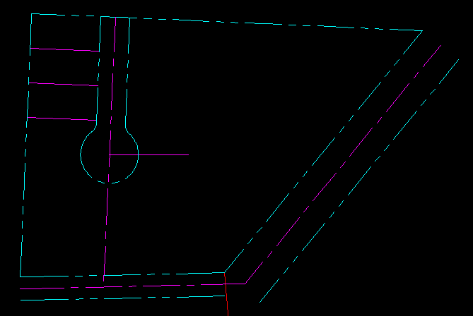

ReMark Posted December 7, 2012 Posted December 7, 2012 Layout out the cul-de-sac. Start with offsetting the streetline 50 feet due east. Might as well include the centerline too at 25 feet. Located the center of the culd-de-sac (I used a line) by way of the coordinates in your instructions. Trim away the streetlines and fillet each side of the cul-de-sac (radius=20). If you trim away the part of the circle that falls between the two streetlines it will make the fillet process go much easier. Quote
ReMark Posted December 7, 2012 Posted December 7, 2012 A close-up of the cul-de-sac. Note the west side has had a fillet applied. The east side hasn't. When using the Fillet command your picks should be close to the intersection of the line and circle as shown in the image above. Quote

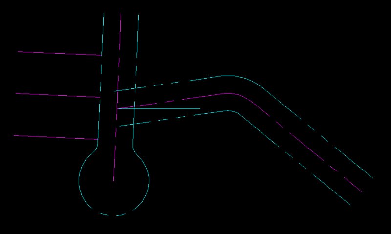

ReMark Posted December 7, 2012 Posted December 7, 2012 Creating the centerline of SW Village Lane. All that is required is for the student to properly locate the starting point at its intersection with the centerline for SW 58th Avenue. Then using the same method of drawing a line based upon distance and bearing construct the angled centerline. Quote

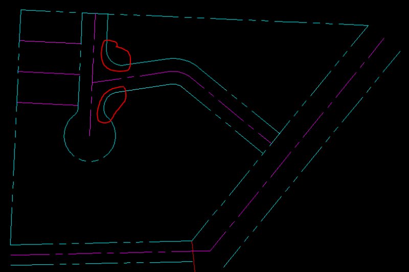

ReMark Posted December 7, 2012 Posted December 7, 2012 Before we move on to what is shown in the attached image let's stop. You previously created the centerline for SW Village Lane. Use the Fillet command with a 55 foot radius to add the curve. Stop. I'd like you to combine the line on either side of the curve with the curve itself so it is one complete entity. How do we do that? Easy...we use the Pedit command. Invoke the command and pick the west line. You'll be asked by AutoCAD if you want to make the line a polyline. Answer = yes. Now type 'J' (for Join) then pick the same line, the curve (arc) and the second line. AutoCAD will join all three lines together. Now offset the centerline 25 feet north and again 25 feet south. Your drawing should look like the above image. 1 Quote
ReMark Posted December 7, 2012 Posted December 7, 2012 Adding the fillets. Once you have trimmed away any unnecessary lines add the two 30 foot radius fillets where indicated. Now start in on the remainder of the lots. I trust you'll have no problems from here on out. This is probably my last post to this thread today (Friday) as I have two back-to-back appointments to go to starting at 3 pm. If I can sneak another look between the two I will otherwise you won't hear from me again until early Saturday morning. Saturday is going to be a pretty busy day for me. I've got a room to paint, etc. Quote

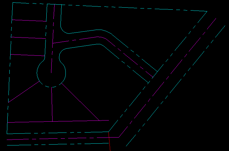

ReMark Posted December 7, 2012 Posted December 7, 2012 (edited) It must be your lucky day. Had a few minutes to whip this up. Laying out lots #4, 5 and 6. I used circles to find intersection points then ran a line from the intersections back to the center of the cul-de-sac. Lot #4 - red circle. Copy the north streetline of SW Kensington Street to the intersection of the west boundary line of lot #4 and the south property line. This will give you the south property line of lots #5 and 6. This line is the north edge of the buffer area between the back of the lots and SW Kensington Street. Lot #5 - yellow circle. Lot #6 - green circle. OK...gotta go. Catch up with you on Saturday. Good night. Addendum: I messed up on lot #6. See the image attached to post #47. There should be a small segment of property line (23.06 feet) going off in a northeasterly direction. My apologies. Edited December 10, 2012 by ReMark Quote
ReMark Posted December 7, 2012 Posted December 7, 2012 Oops. Forgot to show you the finished product. NOW I'm gone. LoL Quote
