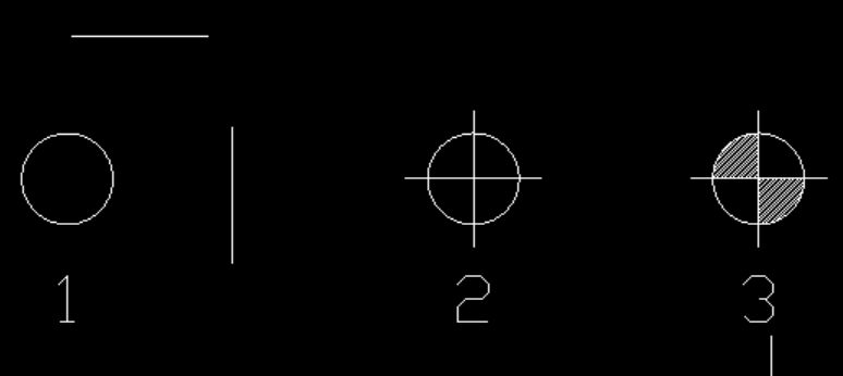

patti0916 Posted January 29, 2022 Posted January 29, 2022 Gosh, I don’t even know where to start. First - do we have to create the BM symbol to match PF? How is this so easy for everyone? Ugh! Quote
John berry Posted January 29, 2022 Posted January 29, 2022 Good afternoon guys. I am working on the oleson village project. It seems this has been around for years. I have completed everything except the last few steps of creating a border and title blocks. Any tips would help thanks. Quote
ReMark Posted January 29, 2022 Posted January 29, 2022 (edited) Yes, you do have to create the benchmark symbol just as P-F has instructed. Otherwise, they start deducting points which in turn affects your overall grade. If you look at the symbol it is just a circle with a vertical and a horizontal line through it with opposite quadrants hatched. Shown below is one simple method for creating the symbol. 1. Create a circle and two lines (in proper orientation). 2. Move the lines using their midpoint to the centerpoint of the circle. 3. Hatch opposite quadrants using the "Pick points" button in the Hatch window. Edited January 29, 2022 by ReMark 1 1 Quote

patti0916 Posted January 30, 2022 Posted January 30, 2022 ReMark, Thanks for the guidance thus far. I’ll go with a few more questions and try to leave you alone. 1) The drawing units are asked to be set as “feet”, is this different from the past? 2) Does the BM symbol have to be a specific size diameter? 3) Am I missing where it notes the thicknesses of the individual lines that make up the plat? If all of these are spelled out sorry for missing them, my head is spinning. ‘Thanks again! Patti Quote
ReMark Posted January 30, 2022 Posted January 30, 2022 (edited) In regards to your questions. 1. If you use the default AutoCAD template (acad.dwt) then you are already working in Imperial units (i.e. - feet and inches). 2. The size of the benchmark diameter is called out in the project instructions. It should be 15. 3. All lines are drawn using the Line Weight setting "By Default" (see Layer Properties). No one line is any thicker/thinner than the other. Edited January 30, 2022 by ReMark Quote
