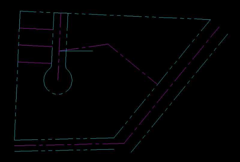

ReMark Posted November 25, 2019 Posted November 25, 2019 (edited) You do realize that some of the purple lines are merely there for reference purposes do you not? I am speaking specifically about those purple lines that represent the centerlines of the roads. The three purple lines to the right of the cul-de-sac would be changed to cyan when moved to the correct layer. Edited November 25, 2019 by ReMark Quote

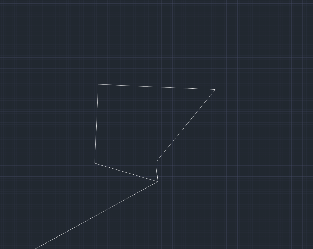

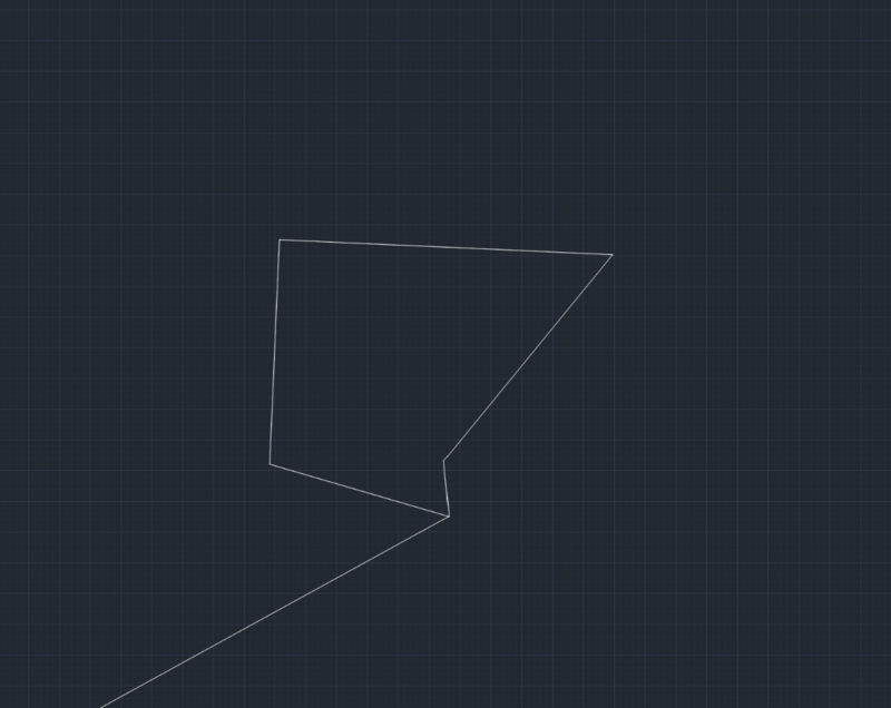

Swatson9041 Posted February 13, 2021 Posted February 13, 2021 I hope you don’t mind helping. I’m confused. When I punch in the @113.66 I get an error saying that I need to specify point or keyword. Quote
Swatson9041 Posted February 13, 2021 Posted February 13, 2021 How do I know the bearing of the western boundary Quote
BIGAL Posted February 14, 2021 Posted February 14, 2021 If you use LIST and select say a line the bearing will be displayed in current units. Line 23.45<20d30'45" Quote
ReMark Posted February 14, 2021 Posted February 14, 2021 On 2/13/2021 at 8:02 PM, Swatson9041 said: How do I know the bearing of the western boundary Expand The bearing for the western boundary of the subdivision is S2d28'56"W. If you have already drawn in the other three boundaries then it is only a matter of drawing a line from the west end of the north boundary line to the west end of the south boundary line since Oleson Village consists of only four property lines. Quote
ReMark Posted February 14, 2021 Posted February 14, 2021 On 2/13/2021 at 6:18 PM, Swatson9041 said: I hope you don’t mind helping. I’m confused. When I punch in the @113.66 I get an error saying that I need to specify point or keyword. Expand First you start with the Line command and proceed to draw a line from the coordinates for the benchmark specified in your instructions . Then putting aside your mouse momentarily turn to your keyboard on the line that says "Specify next point" type in @113.66<N5d27'23W followed by pressing the Enter key. Quote

ReMark Posted December 20, 2021 Posted December 20, 2021 Did you fail to read through the posts contained within this thread? Your boundary issue is addressed therein. Re: Boundary layer. Look at your instructions. I think it is page 2. The student is given a list of layer names, the color to be assigned to the layer and the linetype to be assigned. The Boundary layer makes use of the color Cyan and the Phantom linetype. You need to be drawing the Oleson boundary on the correct layer in order for the color and linetype to agree with the instructions. Quote
Tay Posted December 22, 2021 Posted December 22, 2021 While I appreciate your help I am struggling with this and I did read..... my project instructions does not have a "Boundary" layer to create.... Quote
ReMark Posted December 22, 2021 Posted December 22, 2021 On 12/22/2021 at 12:23 AM, Tay said: While I appreciate your help I am struggling with this and I did read..... my project instructions does not have a "Boundary" layer to create.... Expand Then shouldn't you create one? Wouldn't that be the logical thing to do? The Oleson Village project has been a staple of the P-F AutoCAD curriculum for years. I doubt they would decide to eliminate the Boundary layer at this point in time. Use the criteria I posted above re: Boundary layer and get to work. Quote
