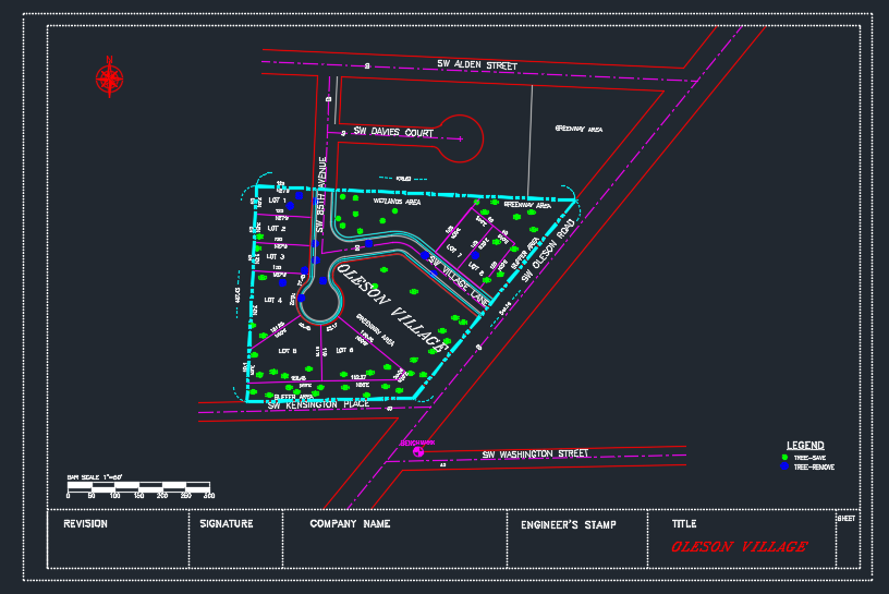

shilpavyas Posted April 27, 2019 Posted April 27, 2019 (edited) On 4/26/2019 at 10:48 PM, ReMark said: I am currently unable to access my CAD workstation and cannot confirm or deny your findings regarding items 1 through 3. As regards item 4 I recall I was able to copy, then paste the coordinates from the PDF to AutoCAD and it worked. I'm not sure what you are doing differently to get MText entries. Expand I just copied the coordinates and pasted it in the command line for the point, but autocad converted it into Mtext. However, I just completed the drawing and want to know reviews from you all. I want to know if there is any method from which you can plot the model space as it is, i.e. with black background. I used plot from page setup manager to plot directly from model space but it is plotted on white background. Tried changing background in custom properties of paper but still no success on that. Edited April 27, 2019 by shilpavyas Quote

ReMark Posted April 27, 2019 Posted April 27, 2019 No, you cannot plot the drawing with a black background. Yes, there are additional Penn-Foster projects that include electrical, HVAC, civil, and structural. You'll have to check the various threads for the proper project PDF file. Once again, I can't supply the files because of a lack of access to my CAD computer. I'm in the process of moving and it's packed away. Quote
eldon Posted April 27, 2019 Posted April 27, 2019 On 4/27/2019 at 10:41 AM, shilpavyas said: .....I want to know if there is any method from which you can plot the model space as it is, i.e. with black background...... Expand If you set WMFBKGND to ON, and then type the command WMFOUT from Model space, you should get a black background wmf image, although with an ink-jet printer, you would get a very soggy print!! Quote
shilpavyas Posted April 27, 2019 Posted April 27, 2019 On 4/27/2019 at 3:43 PM, eldon said: If you set WMFBKGND to ON, and then type the command WMFOUT from Model space, you should get a black background wmf image, although with an ink-jet printer, you would get a very soggy print!! Expand I don't actually want to print the model space, I just want it in jpg format to display in my projects list. Quote

eldon Posted April 27, 2019 Posted April 27, 2019 On 4/27/2019 at 4:46 PM, shilpavyas said: I don't actually want to print the model space, I just want it in jpg format to display in my projects list. Expand Then use the Snipping Tool in Windows Quote
shilpavyas Posted April 28, 2019 Posted April 28, 2019 On 4/27/2019 at 5:04 PM, eldon said: Then use the Snipping Tool in Windows Expand I took screenshot of the screen and I guess snipping tool is also for the same purpose. Quote
