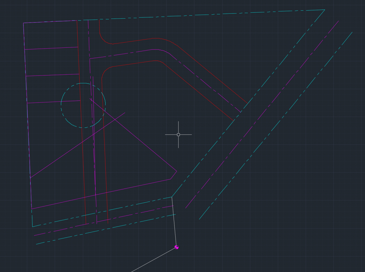

Sorry to bump this old thread, but I've been lurking on this forum, getting a lot of questions answered and now I can't figure out what is wrong with my project.
Everything in the drawing is completely according to the instructions, even some of the ones given in this thread, minus the three property lines for lots 4 5&6 being longer than needed due the the cul-de-sac not being in the "right" spot. I've ran the LIST command and checked all of the lines and I believe them to be correct. If someone could load the drawing and verify that my lines and points are either wrong or right, I've been staring at this for the last week and hopefully I'm overlooking something simple. I've given the dwg and an image.
What is note worthy: I cannot enter bearing info. With LINE running,  picking the benchmark, entering @113.66<N5d27'23''W does nothing. The command line says "Point or option keyword required". From what I've gathered, CAD isn't recognizing the ' and '' as minuets and seconds. I have tried to change the units to architectural with the same results. I am using AutoCAD 2017 for Mac which i have repeatedly found is full of holes, but I was assured by PF that the course is compatible with Mac.

To enter a bearing one must change the Angle Type (under UNITS) to Surveyor's Units and make sure that Precision is set to N 0d00'00" E.
Re: your drawing.  The coordinates for the center of the circle that forms the cul-de-sac of SW 85th Avenue are correct however the same cannot be said for much of the other property and streetlines in your drawing.  The benchmark location is correct.  The alignment of SW Kensington Place is not correct.  The north, west and south subdivision boundary lines are not in the correct alignment.  While portions of the alignment of SW Village Lane are correct the alignment fails at the intersection with SW 85th Avenue as the corner radii are incorrectly located.  None of your lot lines are correctly located.
My suggestion is that with the exception of the cul-de-sac, benchmark and easterly portion of SW Village Lane (from SW Oleson Road to the radiused streetline) everything else be erased and you start over.  Trying to salvage the misplaced linework would just lead to further frustration.
Edited by ReMark
ReMark, thank you for your help. I figured out my issues:
The bearing precision requires that the seconds is actually the " key and not the ' twice. 😑
There was one line with one bearing direction wrong, which threw the rest of the project off.
I guess after staring at it for long enough the frustration made me miss little things like that, I just needed someone else to look at it.

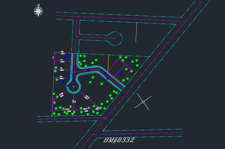

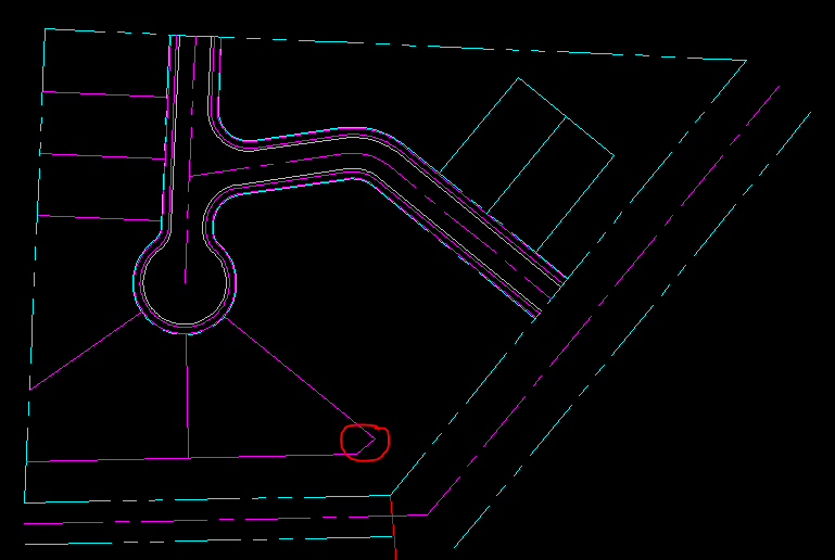

On 12/9/2012 at 12:08 PM, ReMark said:
Oleson Village - Lots 6, 7, & 8.
One slight correction. I forget the 23.06 property line in a previously posted image for lot #6. I circled it in the above image.
The R.O.W. between lot #7 and SW Oleson Road should be 40 feet.
Question! It says  the 23.06 line goes in a "north easterly direction" but do we have bearings for that?

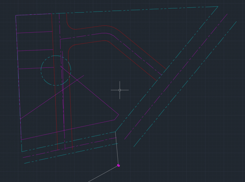

I have completed the drawing part and I am struck in the dimension part. I have attached the image of my progress so far. It took me nearly 3 days to draw this.
Could you please upload the final project screeshot so that I can check how to do the dimensioning.
And could you please see these in the final project and clear my doubts -
1. eastern boundary of lot 5 has bearing of N1d15'19"W Instead of N1d15'7"W if other points are correctly placed.
2. eastern boundary of lot 6 has bearing of N50d43'12"W Instead of N50d21'28"W if the line is to be extended to the center of the cul -de- sac.
3. The project did not mention that which boundary of 85th avenue road is extended north, i.e. outer line or inner right of way. I saw your image in the forum and I extended the outer line i.e. 50 foot wide road toward alden street.
4. You suggested to copy paste the coordinates in the drawing but when I pasted it, it became an mtext line. why?
Would be happy to hear back from you on this!
