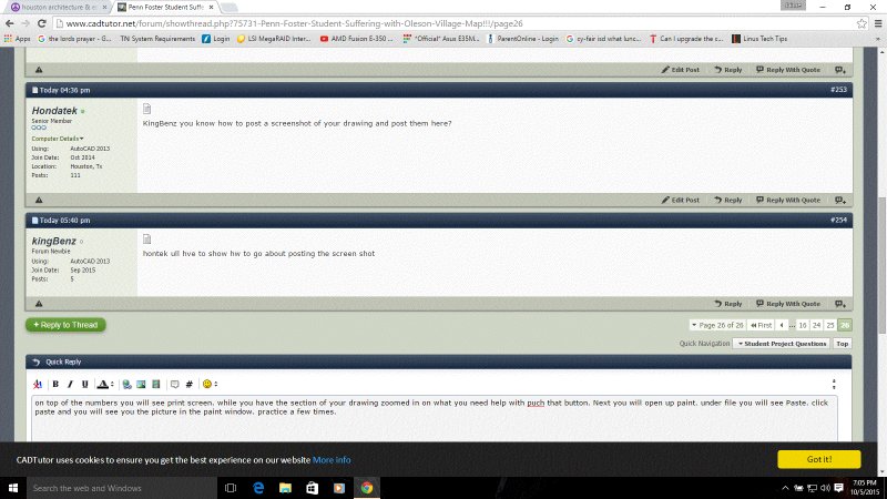

Hondatek Posted October 5, 2015 Posted October 5, 2015 KingBenz you know how to post a screenshot of your drawing and post them here? Quote
kingBenz Posted October 5, 2015 Posted October 5, 2015 hontek ull hve to show hw to go about posting the screen shot Quote
Hondatek Posted October 6, 2015 Posted October 6, 2015 on top of the numbers you will see print screen. while you have the section of your drawing zoomed in on what you need help with push that button. Next you will open up paint. under file you will see Paste. click paste and you will see you the picture in the paint window. practice a few times. then file save or save as. name it. also make a folder on your desttop to keep all you screen shots in. try it Quote
Hondatek Posted October 6, 2015 Posted October 6, 2015 like this. go to advanced when posting and click on the paper clip to upload your screen shot. Quote
