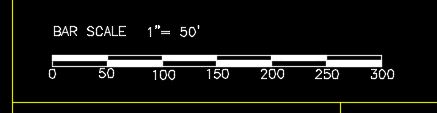

ReMark Posted December 16, 2014 Posted December 16, 2014 An example of a bar scale created by a former P-F student. Quote

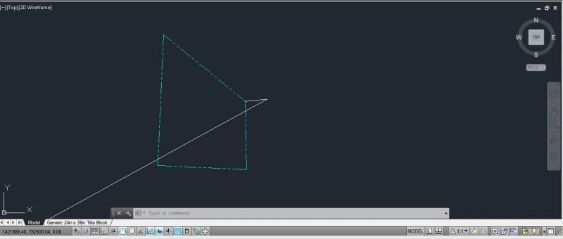

sjsmith Posted January 17, 2015 Posted January 17, 2015 Can you tell me why My Delta X is off? My first line, referred to in the instructions on page 5 as POB, starts at this point and will extend up and slightly to the left which is equivalent to a direction of northwest actually goes back to left, not up. Command: DDUNITS Command: LIST Select objects: 1 found Select objects: LINE Layer: "0" Space: Model space Handle = 1d6 from point, X=1421334.93 Y=783207.62 Z= 0.00 to point, X=1421221.79 Y=783196.81 Z= 0.00 Length = 113.66, Angle in XY Plane = N 5d27'23" W Delta X = -113.14, Delta Y = -10.81, Delta Z = 0.00 Command: *Cancel* Command: *Cancel* Command: Command: *Cancel* Command: *Cancel* Command: LIST Select objects: 1 found Select objects: LINE Layer: "0" Space: Model space Handle = 1d6 from point, X=1421334.93 Y=783207.62 Z= 0.00 to point, X=1421221.79 Y=783196.81 Z= 0.00 Length = 113.66, Angle in XY Plane = N 5d27'23" W Delta X = -113.14, Delta Y = -10.81, Delta Z = 0.00 Quote
ReMark Posted January 17, 2015 Posted January 17, 2015 (edited) If your line is pointing in the wrong direction it's possible you have the direction of North set incorrectly in UNITS. See posts #4, 5, 6 and 7 of this thread (the one you are currently posting to) on how to get started with this project. Edited January 18, 2015 by ReMark Quote

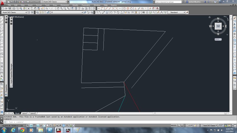

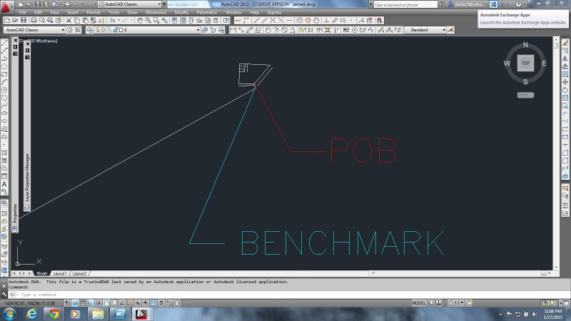

sjsmith Posted January 17, 2015 Posted January 17, 2015 I don't think that I do. Here is a snip of my UNITS. it shows the direction of the line behind it, then I also included a snip of my boundary layer which is also in wrong direction. Quote

ReMark Posted January 18, 2015 Posted January 18, 2015 For the line to be drawn correctly 0 degrees should be to the east, 90 degrees would then be north, 180 degrees would be west and 270 degrees would be south. Quote
sjsmith Posted January 18, 2015 Posted January 18, 2015 I really appreciate the help. I am just struggling with this part, I hope once I get it figured out it will go smooth. Where do I go to set the degrees for E, N, W, S. I even tried to start a new project to see if I had settings wrong, and I had the same result. I am sure I am something wrong, I just don't know where. thanks in advance. Quote
ReMark Posted January 18, 2015 Posted January 18, 2015 It bears repeating, start by looking at posts #4 through 7 of THIS thread. That will get you started in the right direction figuratively speaking. Quote
sjsmith Posted January 18, 2015 Posted January 18, 2015 I will go back and look at those again. I thought I followed them correctly, but must not have. thanks Quote
ReMark Posted January 18, 2015 Posted January 18, 2015 Sure thing. I'll stand by to await your response. Quote
sjsmith Posted January 18, 2015 Posted January 18, 2015 got it. I had changed base direction to N, instead of leaving it at E. Thank You very much. looks much better now.. thanks again. Quote

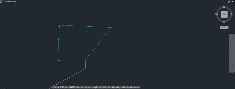

sjsmith Posted January 28, 2015 Posted January 28, 2015 Almost done. Working on the trim layer now. Quote
