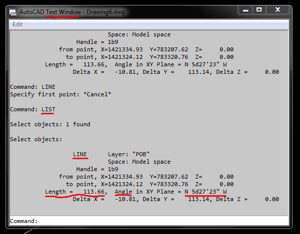

AutoCad Student Posted December 5, 2012 Posted December 5, 2012 I see lots of posts on this project but I'm getting no where. I completed all of the book tests and got no less than a 95 on every single one but when it came time to do the project at the end, it might as well be written in another language. I’ve gotten absolutely no where with this project. I’ve tried to enter just the first simple line coordinates probably 100 times and it just goes away as soon as I hit enter. When I try to enter the second point it says “Point or option keyword required” or the box will have a red outline and it won’t do anything. The line feature is the most basic function in autocad and I can’t even do that. If someone can get me past just the FIRST LINE, maybe there is a glimmer of hope I will be able to complete this course. Thanks!!!! You are my only hope. Quote

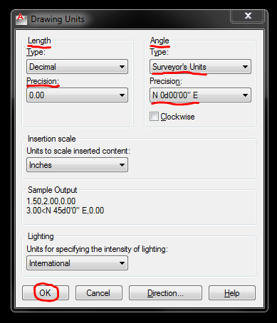

ReMark Posted December 5, 2012 Posted December 5, 2012 (edited) Start a new drawing using the acad.dwt template file. It should be the default. Set your units. Do this via the command line by typing UNITS then press Enter. Under Length > Precision set it to 0.00. Under Angle select Surveyor's Units and set the precision to be N0d00'00"E. Click the OK button. Now I want you to draw a rectangle. Start the Rectangle command and when asked for the first corner point type, at the command line, 0,0. When asked to specify the other corner point type, at the command line, 2000000,2000000 (note that we do not use commas). Then press Enter. Now do a Zoom > Extents. The entire rectangle should now be visible on your screen. Why did I have you do this? Because the whole Oleson Village subdivision including all roads in/around it should fit inside this rectangle. Use it as a visual reference. If you draw a line, or insert a block, and it falls outside the rectangle then you have done something wrong. Comment. I still do not understand why P-F insists on telling the student to establish limits of 0,0 and 20000000,20000000. Edited September 5, 2022 by ReMark Quote

ReMark Posted December 5, 2012 Posted December 5, 2012 (edited) Drawing the POB line. Orthomode should still be disabled (off). Start the Line command. Pick the endpoint of the reference line. Let go of the mouse. For the next point type, at the command line, @113.66<N5d27'23"W (see image in next post). Assuming the line is there how do we verify the length and distance? Answer: we use the List command (one of a couple of options). Type List at the command line then press Enter. When asked to select object pick the line that was just drawn. Press Enter. A text window should appear listing all the information about the line. Check that the length and angle are correct. Edited February 3, 2022 by ReMark 1 Quote

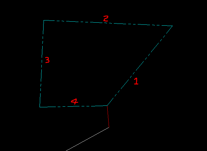

ReMark Posted December 5, 2012 Posted December 5, 2012 (edited) The next four lines that go in represent the boundaries of the subdivision. The starting point for the first of the lines is the end of the POB line we drew previously. Make sure you are on the correct layer. You should be working on layer Boundary (color: cyan, linetype: phantom). Start the line command and pick the end of the POB line. Now leave your mouse alone and do the following. For the next point type @542.16<N39D16'46"E, continue Line command and... for the next point type @676.62<N87D28'25"W, continue Line command and... for the next point type @457.43<S2D31'35"W... finally, for the next point type the letter C for Close. The endpoint of this line should bring you back exactly to where you started. Note that the letter "D" is used to denote degrees, the symbol ' is used to denote minutes and the symbol " is used to denote seconds. Along with the designators for North, South, East and West these character/numbers make up our "bearing". If your phantom linetype looks more like the continuous linetype set your linetype scale to a value of 50. You can do this at the command line by typing LTSCALE then inputting the value followed by pressing the Enter key. Edited December 7, 2023 by ReMark Quote
ReMark Posted December 5, 2012 Posted December 5, 2012 Oleson Village - Boundary. Work in a counter-clockwise direction from line 1 to line 4. Note: I made my POB line red to distinguish it from the boundary lines. It will remain in my drawing until such time as I no longer need it. Quote
