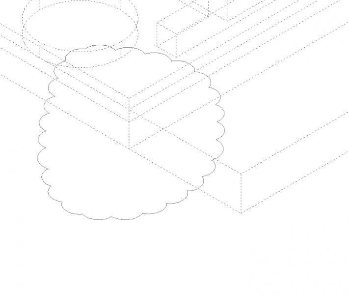

I have attached the image where union selected is one entity but still there is a line showing. I have marked the line with the cloud.
Hi,
I am also attaching the image once the objects are in hidden mode.
Maybe it is the original 2D geometry you used to create the 3D object in the first place.
What is the system variable DELOBJ currently set to?
Or a slight misalignment in the unioned geometry.
