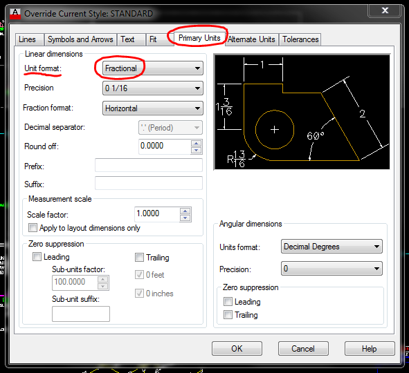

Where do I go in Autocad 2000 to change from decimal dimensions to fractional dimensions, if it is possible of course?
Thank you,
gotchy
Change it in your dimension style. You want the Primary Units tab.
Also, if you want things like 'Distance', Area, Measure, and the properties sheet to read in fractions, execute the Units command and select Fractional for your Length Type.
