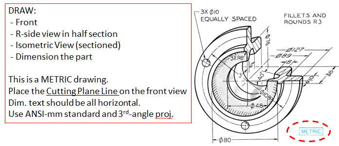

sean214 Posted December 4, 2012 Posted December 4, 2012 i drew in the wrong template and now i cant change it. Quote
rkent Posted December 4, 2012 Posted December 4, 2012 What is in the template you wanted to use that is not in the one you did use? Quote
sean214 Posted December 4, 2012 Author Posted December 4, 2012 The one my teacher gave me i have to use it with evry drawing What is in the template you wanted to use that is not in the one you did use? Quote
rkent Posted December 4, 2012 Posted December 4, 2012 Are there objects in the template or is it blank with only settings, layer names, etc. Quote
sean214 Posted December 4, 2012 Author Posted December 4, 2012 yeah it has settings and layers etc. Quote
rkent Posted December 4, 2012 Posted December 4, 2012 So start a new drawing using the proper template, then copy and paste from the first drawing into the new drawing. Quote
sean214 Posted December 4, 2012 Author Posted December 4, 2012 i dont know whats wrong but its only copying some parts Quote
rkent Posted December 4, 2012 Posted December 4, 2012 Layers locked in old drawing? Layers frozen in new drawing? Quote
sean214 Posted December 4, 2012 Author Posted December 4, 2012 http://www.mediafire.com/?fx1sa9trbcist14 the drawing template http://www.mediafire.com/?fz6ou6x4bcx8b89 Quote

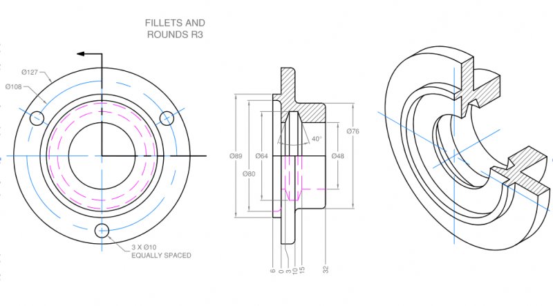

sean214 Posted December 4, 2012 Author Posted December 4, 2012 that worked...now how do i get it to show the three views: right, front and isometric...i only see top Insert current drawing into the correct template as a block. Quote
ReMark Posted December 4, 2012 Posted December 4, 2012 You may have to use the SECTIONPLANE command if you want to generate all three views from one solid model. Quote
sean214 Posted December 4, 2012 Author Posted December 4, 2012 alright i will try and see where i get Quote
ReMark Posted December 4, 2012 Posted December 4, 2012 (edited) Although it appears you went through the trouble of creating a 3D solid model of the cut-away view. I tried using View Base and the two solid models you created (after putting one of them on its own layer) but I did not get the expected results. Almost but not quite. So I would not recommend that as a viable method. Edited December 4, 2012 by ReMark Quote
rkent Posted December 4, 2012 Posted December 4, 2012 that worked...now how do i get it to show the three views: right, front and isometric...i only see top You should open both drawings and copy and paste the borders from the template into your drawing rather than the other way around. Quote
