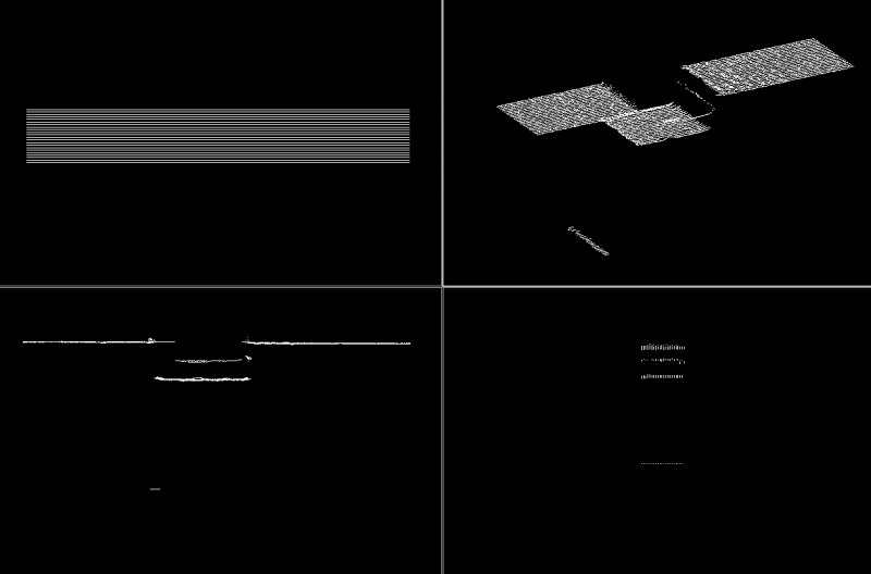

.... So, now i want to create 3D image from that data in Autocad, Can i create..?
These are all the 16545 points that Matlab produced (shown here as single dots). What kind of a 3D image is it supposed to be?
Not helpful? OP already got help from you, fucaro and Jimmy and I didn't think I could add to it. I saw the text file and I just got curious. It didn't look like a single piece of metal plate to me.
Thanks paulmcz.. In image at 1st row, second column is the 3D thing which i want..
As i have seen this image here, now i will try it myself and will come to back if there is any problem...
Actually it is a 2*2 Cm^2 rectangular metal pipe.. And the points in text file are only of the surface.. I have focused a laser stripe on pipe, captured it in camera, extracted points of laser and created a text file, so, these are only the surface points.. Actually this was my first trial, now i will capture accurate points..
