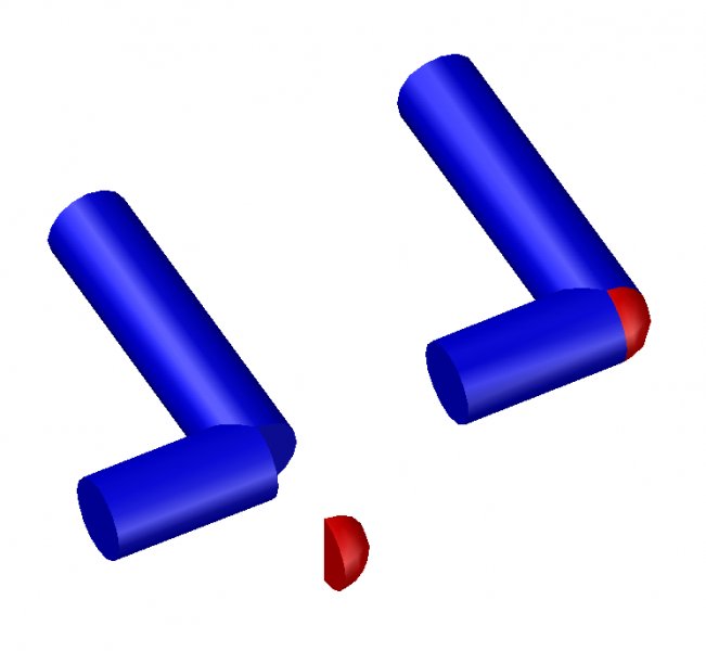

ReMark Posted December 2, 2012 Posted December 2, 2012 mike: The image by yasir doesn't show a 90 deg elbow as we might define it therefore I believe your suggestion would not provide the desired result. Quote

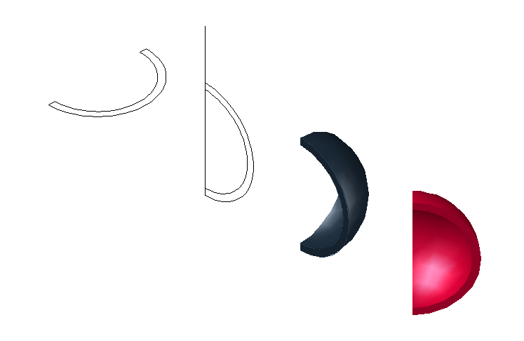

ReMark Posted December 2, 2012 Posted December 2, 2012 This is what I had in mind. I did not create a pipe because this is for demonstration purposed only. Quote

ReMark Posted December 4, 2012 Posted December 4, 2012 I used the Revolve command on a profile. Quote
ReMark Posted December 4, 2012 Posted December 4, 2012 Here you go. Notice I hollowed it out. So...left to right. Create profile. Pedit > Join the two arcs and two short straight lines. Change UCS. Rotate into position. Add my reference object (straight line). Use Revolve command with Object option (select vert line as object). Tell AutoCAD to only revolve profile 90 degrees. Done. The last red object is the corner turned 45 deg so you can see inside a little better. There's probably two other ways to get the same result. This is but one option. If you can't do it after seeing this I would consider a change in careers. Maybe accountant? LoL Good luck! Quote

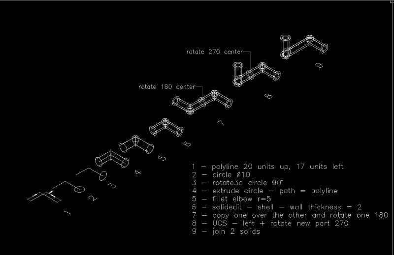

yasir789 Posted December 8, 2012 Author Posted December 8, 2012 Another way: bro can u plz describe more about step 5 that hoto apply fillet in 3d i can do it in 2d but how do i do it in 3d Quote

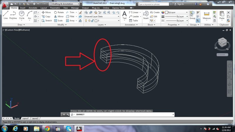

yasir789 Posted December 8, 2012 Author Posted December 8, 2012 mark the revolve comand is grate but it is giving width to the arc corners i want it to be a single line.. can u plz define Quote
ReMark Posted December 8, 2012 Posted December 8, 2012 My post ( #28 ) needs no further clarification. If you made your initial profile correctly then you should get the desired results. Try again. Remember we're using the REVOLVE command not EXTRUDE or PRESSPULL. Quote

paulmcz Posted December 8, 2012 Posted December 8, 2012 bro can u plz describe more about step 5 that hoto apply fillet in 3d i can do it in 2d but how do i do it in 3d Here you go. Quote
