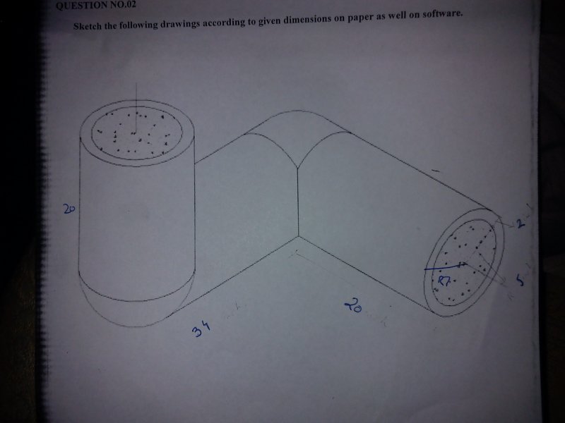

yasir789 Posted December 1, 2012 Posted December 1, 2012 (edited) i m a student ...i m learning autocad 2013 in my university our teacher took a quiz and give us a drawing of a pipe bending on 90 degree plz help me wit this Edited December 1, 2012 by yasir789 Quote

yasir789 Posted December 1, 2012 Author Posted December 1, 2012 i cant bend the pipe as shown in figure Quote

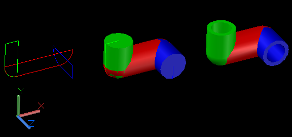

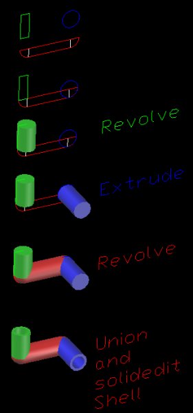

JD Mather Posted December 1, 2012 Posted December 1, 2012 I doubt that Sweep will work (self intersecting geometry). If it doesn't - I would create 3 profiles as shown and then do 3 Revolves. Join and then solidedit shell. Quote

JD Mather Posted December 2, 2012 Posted December 2, 2012 My first example was more complicated than needed. Maybe you can figure out from this example Quote

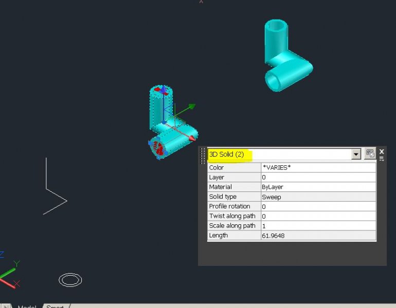

mikekmx Posted December 2, 2012 Posted December 2, 2012 sorry to butt in, but what is wrong with drawing a pathline and a circle and sweeping the circle along the path? bosh bosh Quote
JD Mather Posted December 2, 2012 Posted December 2, 2012 sorry to butt in, but what is wrong with drawing a pathline and a circle and sweeping the circle along the path? bosh bosh Attach your proposed solution here (or picture of...). What's wrong with your solution? I don't know because I didn't try it, because I don't believe it will work. Quote
