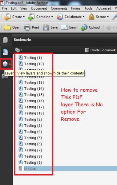

Pdf Layer want to Delete
How to remove this Pdf layers (Delete)?Using Pdf editer Acrobat/9.0 version?
I have Acrobat Pro X and I tried to see if I could in it and I can't see any where that would allow me to delete a layer. I also tried to open the PDF in Illustrator CS5.1 but the layer information did not transfer over from the PDF in Illustrator. I also tried in Corel Draw X6 and it did not show the layers either. :(
Sorry looks like you are stuck with it.
In Acrobat X, in the layers pane there is a little drop down button at the top, and in there is the 'Merge layers' option where you can easily merge all the layers to layer 0 say and then layers are effectively gone (drawing remains unchanged though).
Not sure if Acrobat 9 has something similar.
Yeah I saw the merge layer command. If there is info on this layer wouldn't it get merged onto the other layer?
Yes. Which is what we want right?
